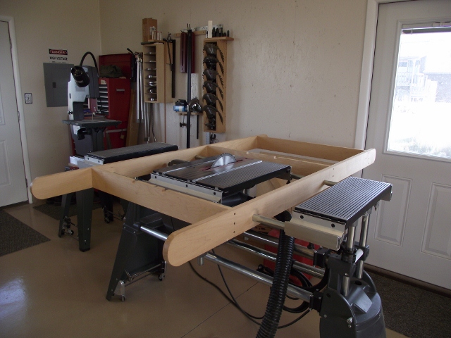

OK, hope some of youse are still keeping your eye bowls on this ....
I made the sled, actually a piece of cake, just took me all day ....
It works great, what a dream it will be cutting these panels. I glued up a half inch thick panel out of scrap to simulate my real ones. Works slick.
My question is this though. How accurate should it be? I am at about a degree off of square. Can a sled do better than that? I am going to make the "fence" on the operator side adjustable so you can compensate for changes in the future, but I just need to know what kind of accuracy I can expect. I used two framing square setting back to back on either side of the blade when I aligned the "fence". Seemed like a good idea at the time ...
Pictures coming, but I need to make the safety box first.
Anyway, what say you..... accurate enough? I was hoping for square .....

I would consider 1° excessive for a sled.rjent wrote:OK, hope some of youse are still keeping your eye bowls on this ....![]()
I made the sled, actually a piece of cake, just took me all day ....![]()
My question is this though. How accurate should it be? I am at about a degree off of square. Can a sled do better than that? I am going to make the "fence" on the operator side adjustable so you can compensate for changes in the future, but I just need to know what kind of accuracy I can expect. I used two framing square setting back to back on either side of the blade when I aligned the "fence". Seemed like a good idea at the time ...![]()
Read up on the 5 cut method for aligning sleds.

I did, I am still trying to recover from thatJPG wrote:I would consider 1° excessive for a sled.rjent wrote:OK, hope some of youse are still keeping your eye bowls on this ....![]()
OK, I thought so. I can , and want to, get it closer, but I didn't want to waste my time if that I all you can expect.
thanks for the feedback, I will prevail...

I agree JPG. Mine is almost dead on. Since mine is so wide I was able to clamp the rear fence on and make test cuts. Then adjust until it was square and then screw it in place. I removed the screws and added glue and then screwed it back on.

Your sled inspired me John, in many ways. Your adjustment method is what I have planed except I will attempt to keep the fence adjustable, at least for a while. I am using the floating tables emulating your idea about the "outrigger" slides that you have, because I wanted to use the Shopsmith "system". I may regret it, but there it is ....jsburger wrote:I agree JPG. Mine is almost dead on. Since mine is so wide I was able to clamp the rear fence on and make test cuts. Then adjust until it was square and then screw it in place. I removed the screws and added glue and then screwed it back on.
I am pretty sure, my fence can be dialed in to perfect, but I just wanted to make sure it was a realistic goal.
Didn't want to chase my tail

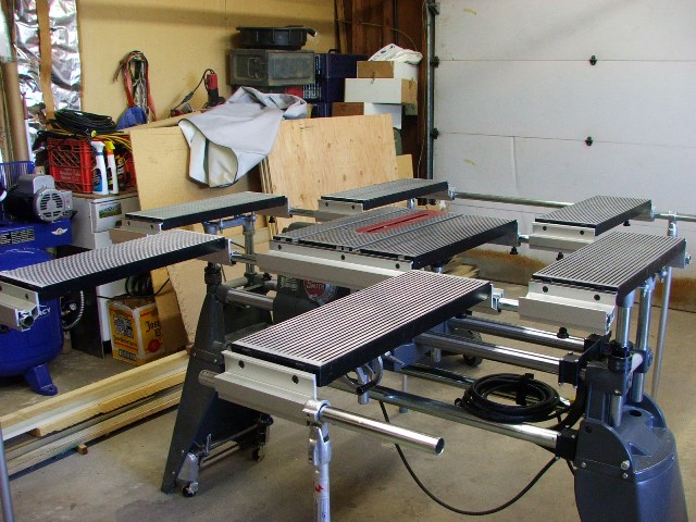

Re: Time to make a sled?
OK, by outrigger slides I guess you mean this.rjent wrote:Your sled inspired me John, in many ways. Your adjustment method is what I have planed except I will attempt to keep the fence adjustable, at least for a while. I am using the floating tables emulating your idea about the "outrigger" slides that you have, because I wanted to use the Shopsmith "system". I may regret it, but there it is ....jsburger wrote:I agree JPG. Mine is almost dead on. Since mine is so wide I was able to clamp the rear fence on and make test cuts. Then adjust until it was square and then screw it in place. I removed the screws and added glue and then screwed it back on.![]()
With floating tables you can do this. Just slide the floating tables up against the main table. In this case I would make the sled 4" wider than the main table.
