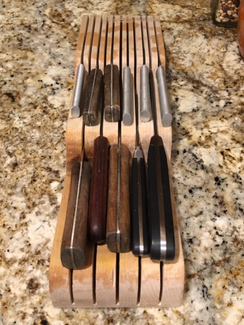

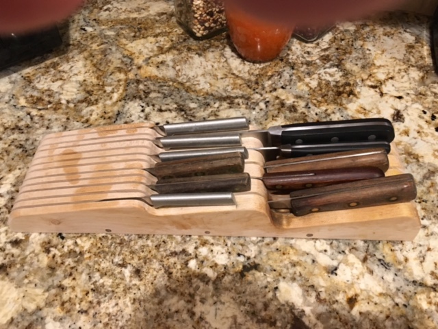

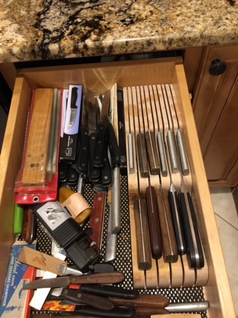

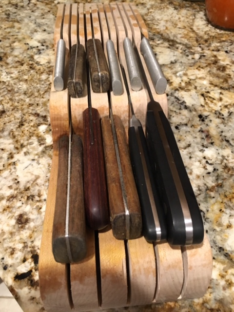

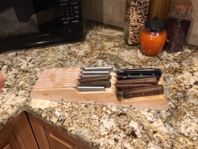

Wife wanted knife rack for her precious knifes (those used daily) but she didn't want to give up counter space. I was in a kitchen supply store and saw a neat rack the would fit in a drawer. I drew a paper copy and made one. You can make it as wide as you want since every section is cut on the bandsaw and held to the adjacent one next to it with a dowel. Each section holds 3 1/2 knifes two little and one big. I widened the joint between each section to store an extra knife in each. This was more or less proof of concept when my wife latched onto it and it was pressesd into service and we have used it for the 6 years.
If I were do another I would not put a saw kerf down on the bottom level the long knifes don't use I and I think it would look nicer with out it.
I left them un finished they were made from maple. I touched them with wet hand to take these pictures.
Excuse the mess in the knife drawer, there is a mix of steak knifes, and floral knifes also in the drawer. Any loose sharp knives have sheafs.
