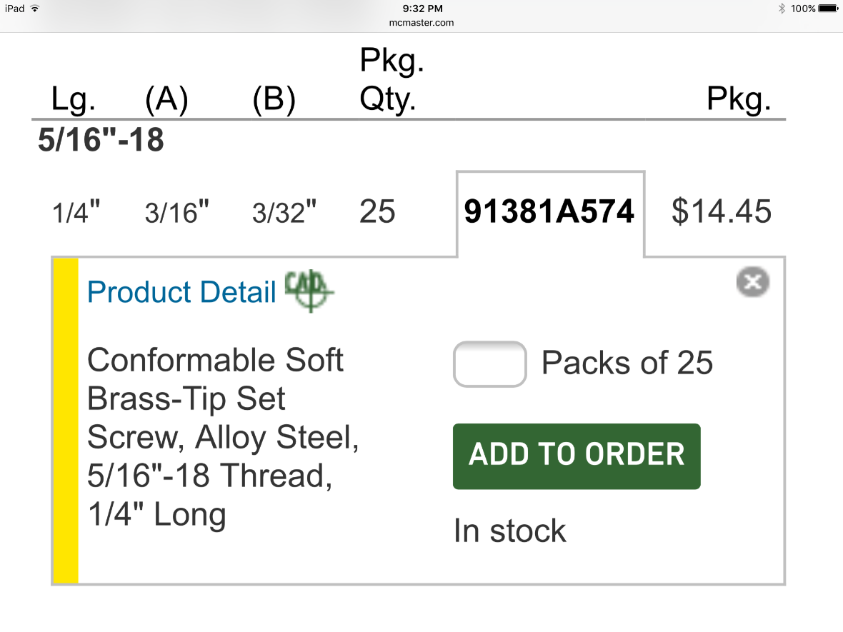

What part number did you order to get brass point set screws?
Is it 222458?

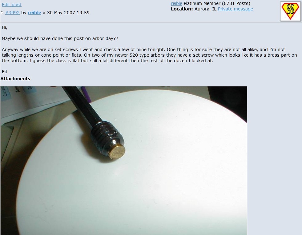

I take that no one has looked up the history of these brass setscrew posts? Anyway not that it matters but the earliest I could find with my name attached was this one:
ScreenHunter_151 Apr. 16 16.01.jpg (189.8 KiB) Viewed 8298 times
So "we" have know about this for a few years now.
BTW I think the setscrews with the brass tip are expensive, like maybe over $3 each if I'm recalling correctly, for sure they are more then the $.80 ones that I have purchased.

dusty wrote:They're not cheap.
I don't usually think of McMaster Carr as the low-cost leader, but ...
