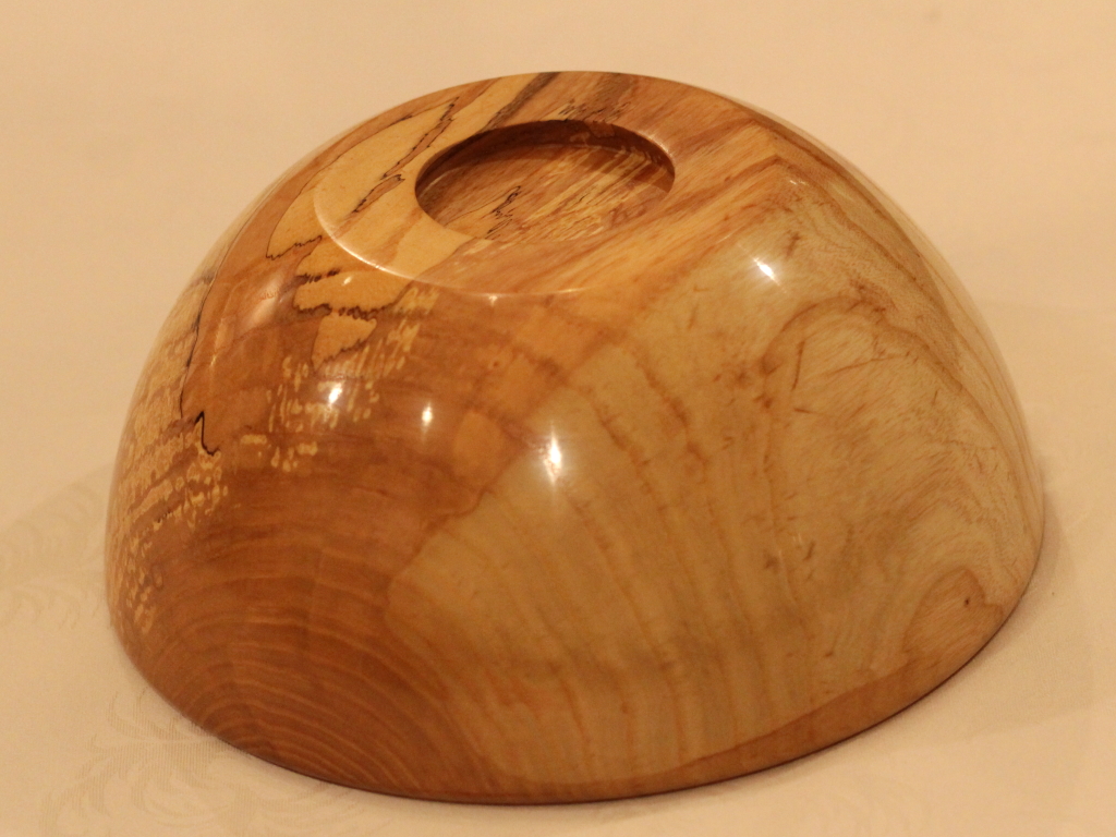

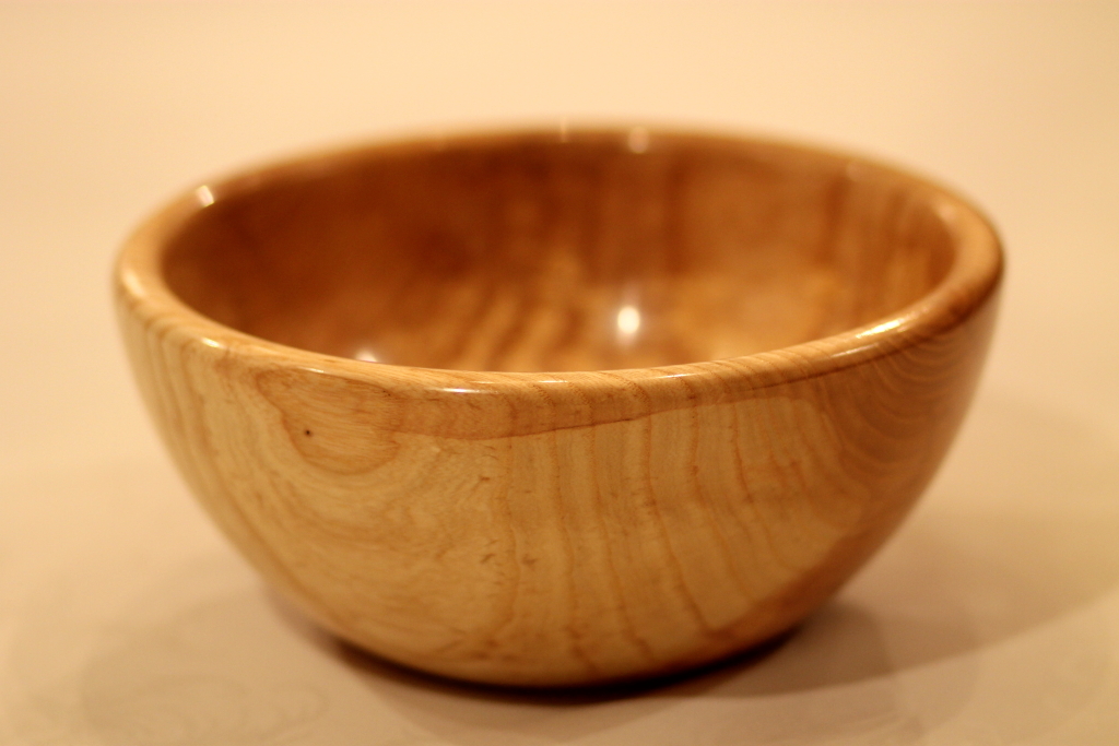

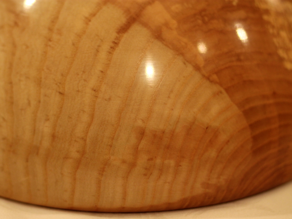

The finish is finally on the bowl, and I'm pretty pleased with how it turned out. A good portion of the bowl is spalted. I do hope my niece likes the rustic look!
My old can of Minwax satin wipe-on poly had gone bad on me, so I started finishing the bowl with the gloss stuff. The finish built nicely, but it was just too darned glossy for me, at least on this bowl. So first I tried buffing it with some 0000 steel wool, and that worked nicely on the outside. But there were some grooves on the inside of the bowl that I hadn't sanded out completely, and the steel wool didn't buff out the gloss in the crevices. Which of course only served to accentuate the defects. (No pics of those! :D ) Next I bought a new can of the satin wipe-on poly and applied a couple of coats. That took care of the problem pretty nicely.
Not too bad for a first bowl, I think. The very last photo is of the same spot where I had the tearout problems that prompted this thread. As you can see, the hook I burnished onto the round-nosed scraper took care of that quite nicely.
