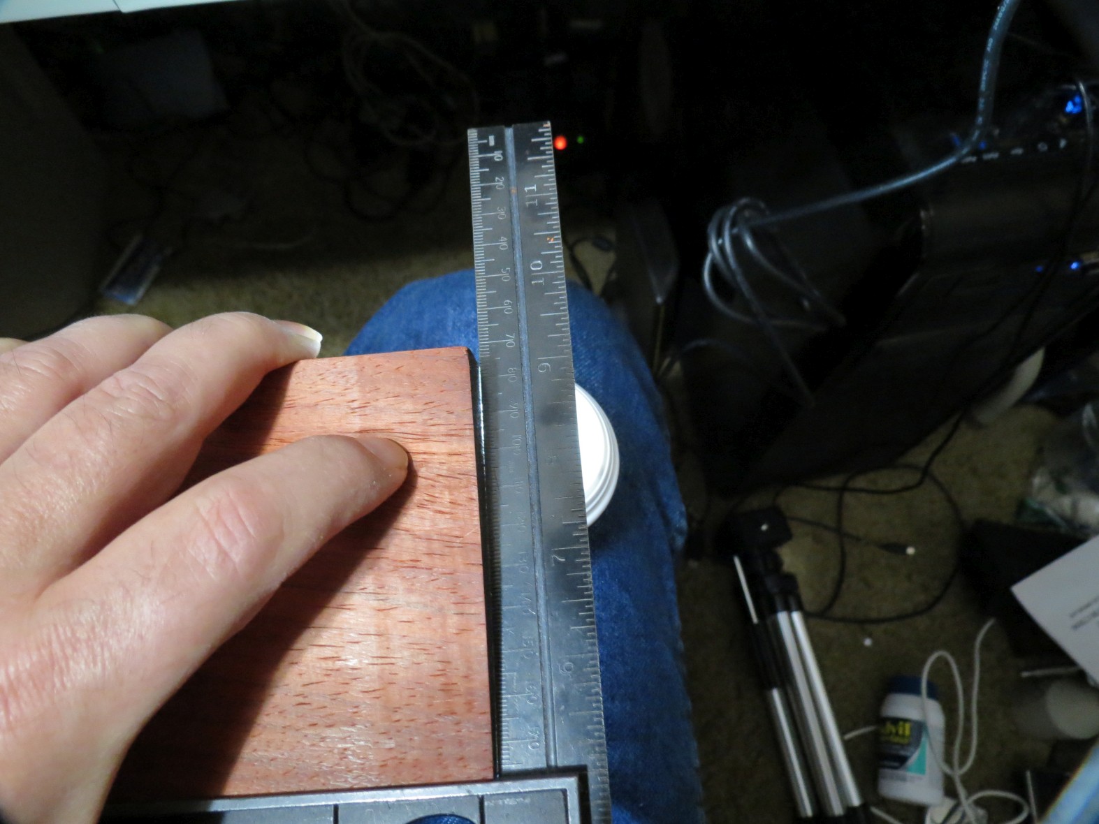

by reible
I don't normally measure to see how far things like that are off but I do use a square and if I can see light I fix it. I went to the trouble of find a piece of wood that is close to 4" wide, actually 3-15/16 and with an error of .008" via a feeler gauge this is what you see:
I don't know at what point you can't see light anymore but it is a lot less then this.
Re: Perfect Cross-Cuts?
Posted: Sat Mar 18, 2017 11:31 pm
by Hobbyman2
I cant tell for sure,,,,, the picture looks like the cut starts out {{{{{ends up, depending on the direction you are feeding the stock,,,}} it's pretty straight for a little bit ?
Do you use the hold down on the miter gage ,I wouldn't think the table would move using the miter gage ?
.008 is like 8 100ths of 1 1000th
