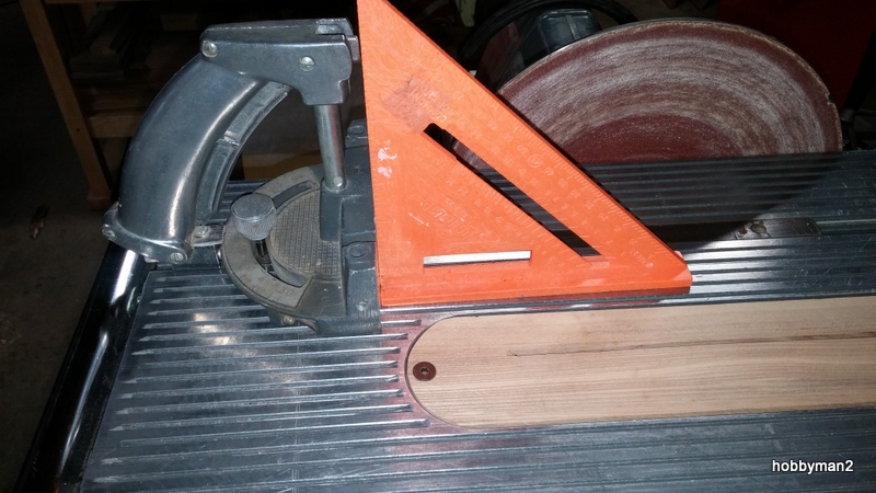

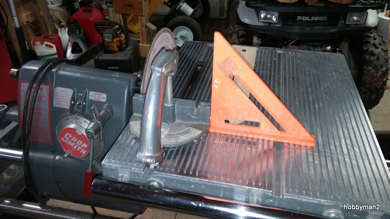

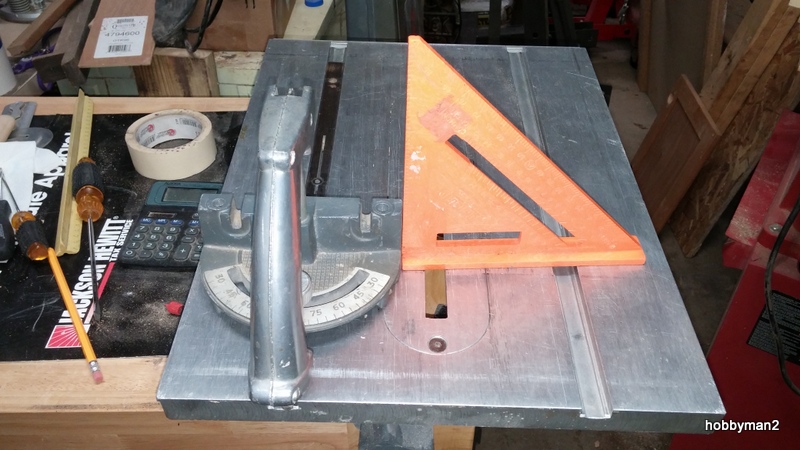

Since ya had so much fun with that one here is another one that might stir ya up
a perfect miter gage set up.
The miter gage works on both tables with no issues just like the table set up .
Other then it is the wrong miter gage for the 510 ,, the glides are wrong type , one sets in the grove.
Hobbyman2

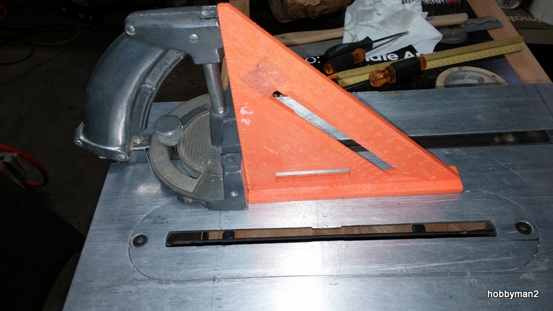

The glide adjustment is not just for the rocking motion .

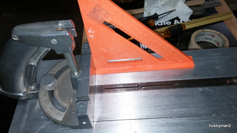

So if the miter gage isn't square to the table ,,,as well to the blade ,,,wont you end up with off square cuts,,,,, or compound miters if you set the gage to a angle and clamp the board to the gage?
My point was the gage has to be square in all directions .

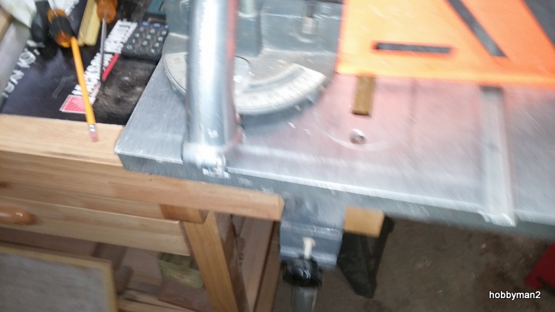

The miter gage will work on the 510 table,,,,, however it seem one of the glides rides more in the dust grove and the gage drops just a bit , not only that I fear the glide will wear faster and uneven not setting flat .

Well,,,, I have 2 tables ,,a 500 and a 510 ,,,,I can switch from one to the other with out issues using the same miter gage now that they are set up using this method,

Hobbyman2 wrote:So if the miter gage isn't square to the table ,,,as well to the blade ,,,wont you end up with off square cuts,,,,, or compound miters if you set the gage to a angle and clamp the board to the gage?
The edge of the table is not a reference surface for any operation. The miter bar slots are the reference surface and it does not matter if they are parallel to the sides of the table or perpendicular to the front and back of the table.
Two things are necessary for perfect cuts. First, both miter slots must be parallel to each other. They are the reference surface for aligning the table. The miter slots must be parallel to the blade. I could care less where the edges of the table are in reference to the blade. Second, the face of the miter gauge must be horizontally square to the miter bar to get a 90° cut. The end of the miter gauge does not need to be vertically perpendicular to the table. It is not a reference surface and has no bearing on anything. Besides it is not a machined surface. Likewise, the face of the miter gauge does not have to be perfectly vertical to the table. The stock will still touch the fence all the way across.
