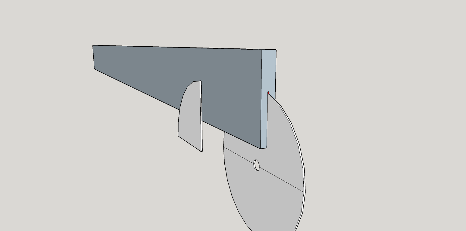

We did all of this without any information on the "hook plates". We know not whether there would be physical interference in an end cut kerf and yet that method (introduced by reible) has been rejected.
It is sometimes important to fully understand the problem before a complete solution can be determined.
If you really want to do this using your Shopsmith, it can be done and done safely. If concerned about the void space that would created by cutting the slot as depicted here, that void can be filled by gluing in an appropriately sized filler also shown here.

I did the same thing on a bed a few years ago and did it just like reible and dusty posted. It was quite easy using the saw.
