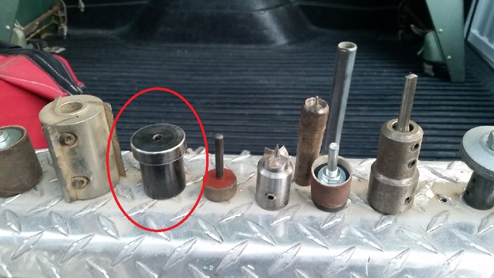

Here is a few more pictures, and accessories.

I noticed the Lathe Screw Drive is missing the Screw
A #14 x 1-1/4" Wood Screw is the size it needs
