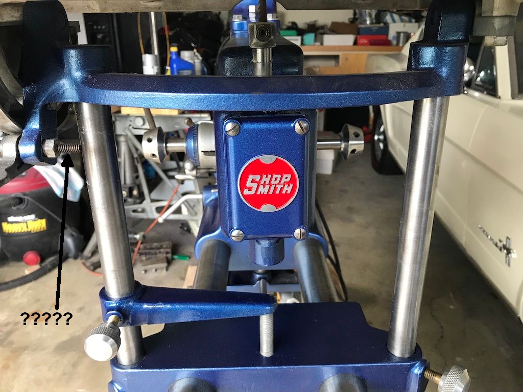

Re: New ShopSmith Owner!
Posted: Sat Sep 15, 2018 4:54 pm
by csxeng
Thanks Russ! I appreciate the info that you and the other members have shared. Here are some pictures of the Jigsaw all done. The Jigsaw works very well! One puzzling question, How does the saber saw support (134-13) work, as I see a hole in the post and a adjusting jam nut. I don't see anything on what it does or how it's hooked up to anything even in the manual.
Dave V.
Posted: Sat Sep 15, 2018 6:38 pm
by JPG
That is a gorgeous restore, But what is at the end of the arrow?
Posted: Sat Sep 15, 2018 7:04 pm
by jsburger
JPG wrote:That is a gorgeous restore, But what is at the end of the arrow?
It looks like a non OEM bolt that replaced P/N P1316 that holds the table tilt indexing lever. It should be a 1/4-20 X 1 1/2" hex bolt.
