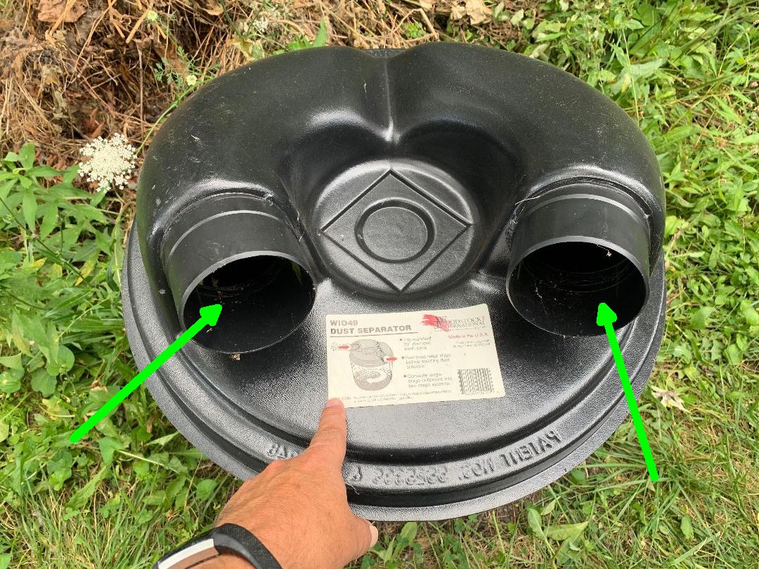

Last question: Have any of you had ANY experience with a cyclone that is basically a lid with two 4" holes, the incoming piece having a short run inside that directs the flow sideways in the bucket? The only compelling case for it is cost. The other alternative is the much more expensive dust deputy XL which runs about $250. At my woodworking supply store here, they only sell these lids as a cyclone alternative, which surprised me.

Those 'lids' are a Thien(sp?) separator. AIUI they work fairly well.

This is the link to the Thien separator forum. http://www.jpthien.com/smf/index.php?board=1.0

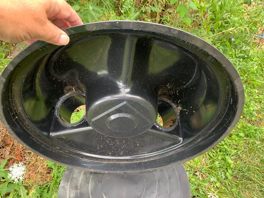

I have had one of these for maybe 20 years. It fits the top of a 20"dia. garbage can. I don't always use it as it works better at chips then thing like sanding dust.
I did make a minor modification to mine, the ports were just holes that you stock the hose in but I added some hard attachments to make it easier for me to use.
