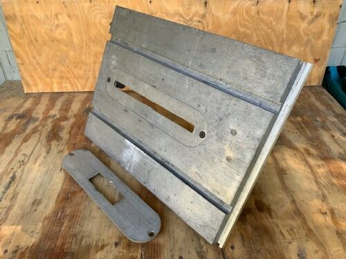

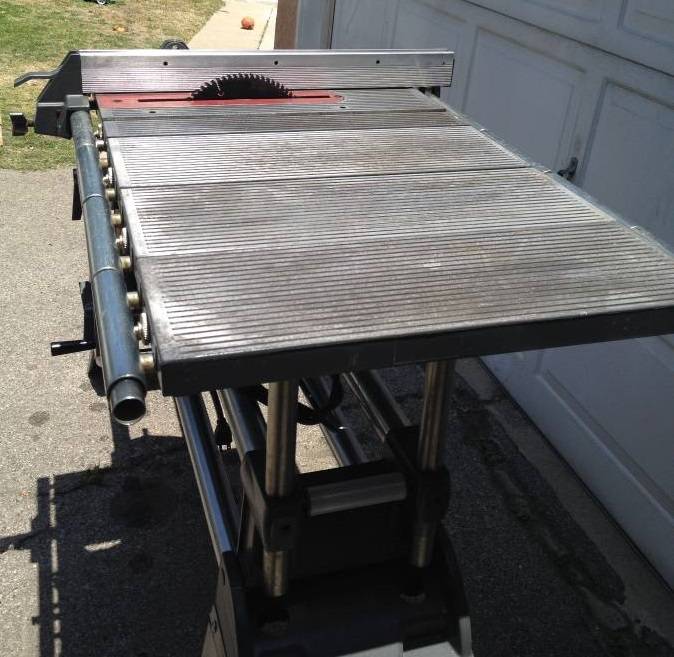

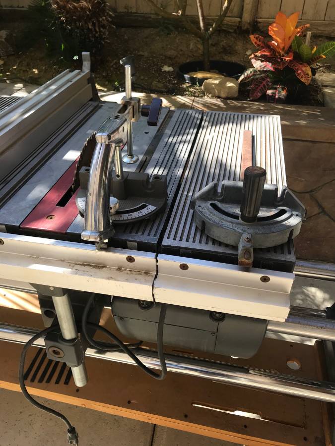

The table size and configuration is best way to differentiate (at least for me). Each type also has a specific fence for use with it, and there are variations in rail details, but basically:
A 500 table is smaller and has no rails for connecting floating tables.
A 505 and 510 table have round rails in front and back for connecting pipes.
A 520 has extruded aluminum rails front and back for connecting pipes.
