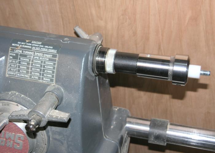

Another option might be to purchase and adapter from PSI for $16.95:bdhoward wrote:OK... stopped by my local Wood World in Dallas today and the manager showed me what I think I need.
A Collet Chuck with a 5/8" (0.625") insert. They have them with an adapter to mate up with the ShopSmith for about $150.cost.
http://www.pennstateind.com/store/L5818.html
Purchase a collet from Beall Tool Company for $79.00:
http://www.bealltool.com/products/turning/colletchuck.php
and purchase a 5/8 collet from a place like Enco for $12.99:
http://www.use-enco.com/CGI/INSRIT?PMAKA=891-7024
Total expendure excluding shipping $108.94.
The Beall collet uses standard ER-32 collets that are available in a size range up to 3/4 inches. The setup would look something like this:
[ATTACH]3020[/ATTACH]
Mine is set up for bottle stoppers with a 3/8 inch bolt cut off and a piece of UHMW for a sizing bushing.
John
- SSBEALL.JPG (40.99 KiB) Viewed 3860 times
