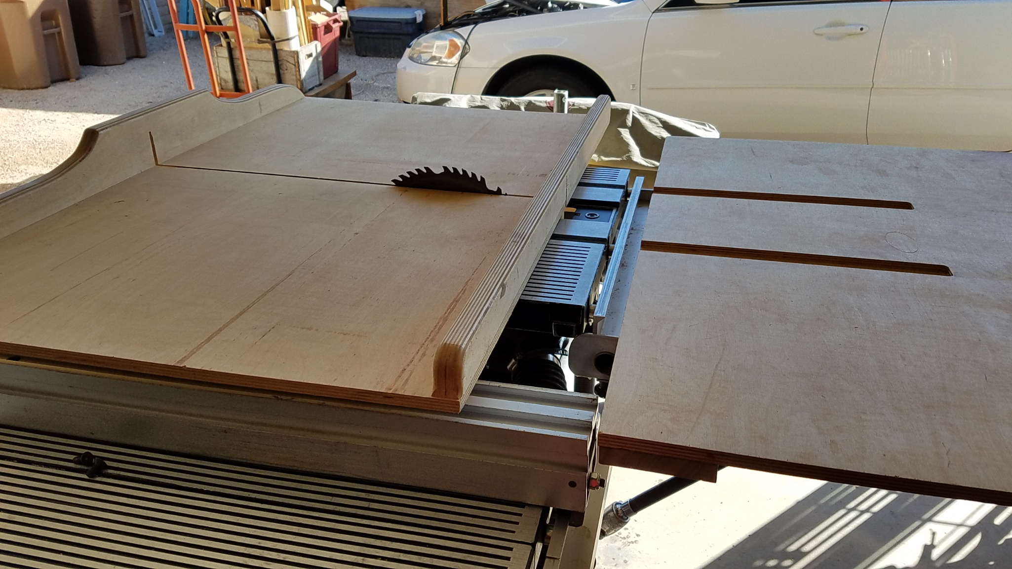

Re: Cross Cut Sled Number ???
Posted: Sat Nov 05, 2016 1:01 pm
by dusty
I have built at least two or three of these and either become dissatisfied with my workmanship or find that my design is lacking.
The last sled that I built has worked fine even though I have abused it by cutting work pieces that were too thick. I am going to have to build another one.
The design will not change though the dimensions might (probably will). I find that I need 24" of cross cut capacity much more frequently than I had thought. The new sled will accommodate that. To support the sled on the infeed side, I will need an infeed table just to provide support. I am thinking about 10" to 12".
To prevent the cross cut sled from clearing the blade on the infeed side, I will size the runners (along with the cutouts on the outfeed table) to allow a full width cross cut while not exposing the blade.
I will have to discipline myself to NOT CUT 2" thick materials on this new sled.

Re: Sled??
Posted: Sat Nov 05, 2016 6:08 pm
by jsburger
Make a stop for your out feed table to stop the sled. Then add a safety block to the in feed side to hide the exposed blade. As you can see on my sled the runners in my case hit the blocks glued on the out feed side cross piece.
I would just bolt a removable block in the center of the out feed table and then attach an appropriately sized block on the in feed side to hide the blade.
