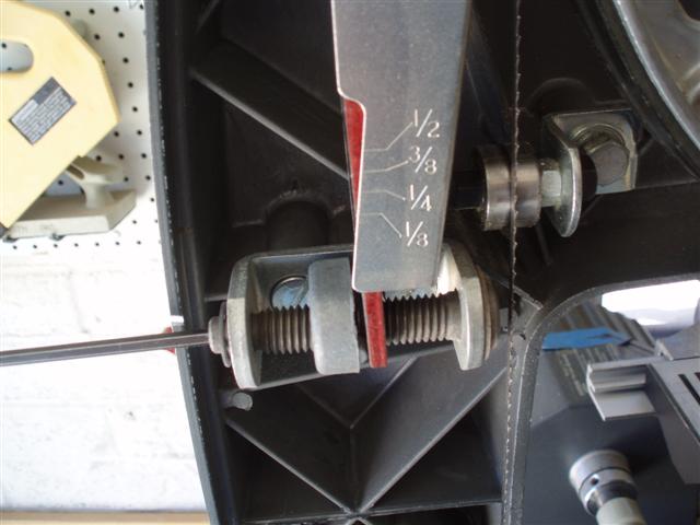

I keep looking at the Belt Tensioner and I realize this is a dumb question but how do you tell which fraction the belt is tightened to?? I see 1/4, 3/8 etc but I'm not seeing a mark or marker to align anything to?

There should be a red plate that moves as ya tighten the set screw. That is your alignment point.

The 'red bar' is a spring. The calibration marks indicate the position of the edge of the bar when it has been 'bent' far enough to provide correct tension to the blade for the size blade indicated.
Being a spring, it likes to be 'relaxed'. Also when under tension, the upper bearing and arm are also under tension. The arm/bearing are not a spring, and do deform under extended lengths of being under tension. This deformation can be 'corrected' by pulling out the bottom of the upper wheel while pushing in at the top, but this flexing will eventually weaken the arm and require more frequent 'correction'.
Bottom line - It is best to relieve the tension when not being used for extended periods of time. This is not necessarily every day. The bandsaw gods will not rain on your parade if you do not do this religiously, but tis a good idea.

Bandsaw Tension Mechanism
A Picture Rather Than Words
[ATTACH]8560[/ATTACH]
Tension is set for a 1/8" blade.
- P4110016 (Small).JPG (44.61 KiB) Viewed 2959 times
