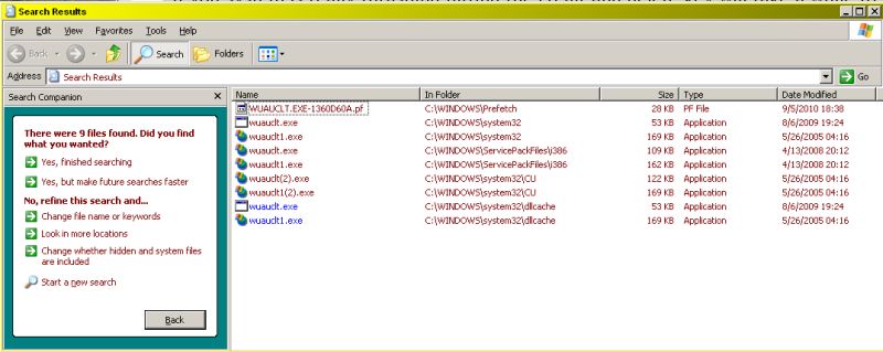

I have experienced the 'sluggish response' symptom occasionally, but have never caught WUAUCLT with Task Manager.
Should I be concerned with the following 'search' result????
[ATTACH]10303[/ATTACH]
Running XP Pro SP 3

First off from the reading I have done on the subject WUAUCLT.exe should only be in the SYSTEM32 file. My understanding is that this module/program has been used in the past by Malware, Spam and Trojans because when it runs it usually is transparent to the user.
WUAUCLT is a valid module/program used by Microsoft to check for system updates. Somewhere around the beginning of Aug something happened and people started complaining about their system trashing. Some are seeing it and others aren't. Finally toward the end of Aug Microsoft stepped up and said yes there is a problem. Some suggest it is with Microsoft Security Essentials, others say a windows update others simply are having the problem.
In any case from what I read you really don't need WUAUCLT at all. If you don't have it you will have to do your own check for updates for you various programs.
Therefore here is what I did. I first notices the problem after a Trojan. I caught the trojan and knocked it off my system but then every so often I caught my machine thrashing. I finally narrowed it down to WUAUCLT. At first is simply stopped the WUAUCLT everytime I caugth it running. Then I did a few searches and found out about the bug.
I also found out that the module should only be in System32 folder so I did a find in my find I found the module in more at than one place and once place was the same as your in the prefetch folder. Mine in the prefetch had the same modification date as the day I got my trojan. If you look at yours everyone is an rather old date except the first in the prefetch which has 2010 date in it.
If I was you I would delete all WUAUCLT.exe except the one in the
Windows/system32.
They will go to you trash can so you can try running the system for a few days with them there and if everything seems okay you can then empty the trash.
