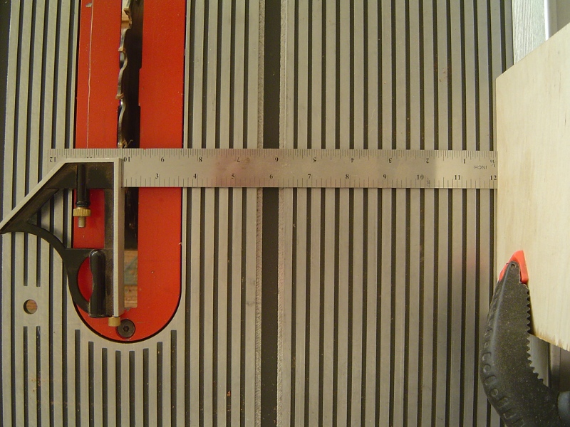

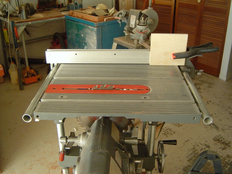

Here are some pics to show what I meant by spacer block and to show how I use the gauge to set a cut up too. I'm sorry that I wasn't clear with my earlier post.
[ATTACH]12597[/ATTACH]
To measure for my cut I'll have the spacer set up by the blade so I can measure to it.
[ATTACH]12598[/ATTACH]
After the measurement is made I'll slide the spacer toward the front of the fence to allow clearance before the blade contacts the wood. Naturally I'll have to use the miter gauge to make the cut.

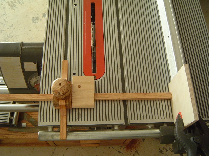

Setting up a cut with the gauge:
[ATTACH]12599[/ATTACH]
The block of wood that straddles the adjustable bar is used to align the blade to. I extend the bar past the block the desired distance and that's the length of the cut. I'll slide the fence with the spacer to kiss the end of the bar and I'm ready to cut.
Another benefit to the gauge is that if I need to move the fence for any reason, it's easy to place the fence in the same spot.
I also use the gauge to align the fence (or check alignment) and to check that the table is square to the blade.

Additional note for those that used the rip fence to gauge a cross cut - and even if you now use a fence separation block.
The only reason to incorporate the rip fence into a cross cut operation, with a separation block is if you need to make repeated cuts of the same length. Other than repeated cuts, it takes less steps to measure and mark the board. Then saw on the proper side of the mark.
It is safer to leave the rip fence out of THRU cross cuts unless really needed. The rip fence can be safely used against the end of a board when making NON THRU cuts. like dados. It is the THRU CUTS that are the dangerous ones.
When using a cross cut sled, (assuming the edge or center of the sled touches the blade) all that is necessary after marking the measured distance, is to place that mark on the saw kerf line of the sled.

Good point Chuck. I am making a dozen dresser drawers and I was rough cutting a pile of 96" x 18" MDF down to size. They were cut offs I bought from the Home Depot "Cull Cart" for 50 cents each. I used the fence to avoid repeated measuring. This is a process I do frequently.charlese wrote:The only reason to incorporate the rip fence into a cross cut operation with a separation block is if you need to make repeated cuts of the same length.
As embarrassing as it is to be called out, I learned something here and I hope others did too. As others have mentioned, I've done this for years and never had a problem. But I knew right away what Dusty was talking about because I've seen Norm Abram use a relief spacer many times so I know it's a best practice.
