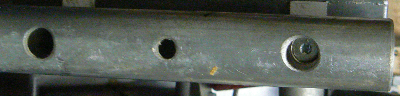

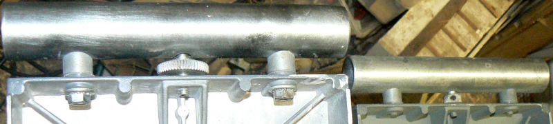

[ATTACH]13996[/ATTACH]
This is the most obvious difference. The holes are to allow access to the screws that attach the rails to the table front and rear. The earlier table is tapped as you will see in the next pix.
[ATTACH]13997[/ATTACH]
Notice the difference in the thumb screws that tighten the table rails to the connecting tubes. The early version(on the right) had smaller diameter thumbscrews. Notice the ss universal tool kit lever holes.
Also notice the later version has nuts securing the rails to the table. The rails have threaded studs that pass through holes in the table edge and a nut with a captive lockwasher is used.
The early version(on the right) appears smaller in the pix since it is further from the camera.

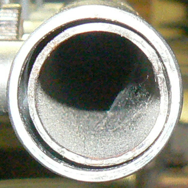

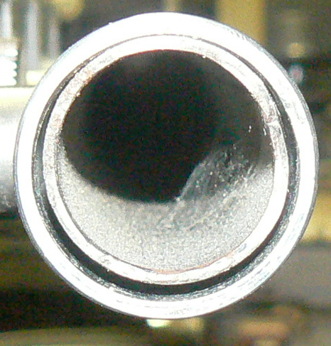

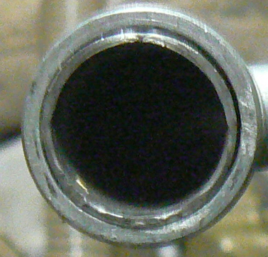

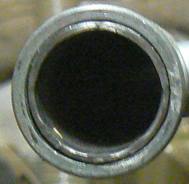

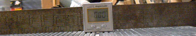

510 'centering' of tubes to rails
[attach]13998[/attach]
The two tables are adjusted to be the same height when tubes are centered to the rails.
[attach]13999[/attach] [attach]14000[/attach]
The earlier version with the tube loose(on the left) and the tube tight(on the right). The thumbscrew is pushing from the right side in the pix.
[attach]14001[/attach] [attach]14002[/attach]
The later version also loose(left) and tight(right). The thumbscrew is pushing from the left side in the pix.
Notice the greater tube to rail slop with the later version. The connecting tubes are essentially 1.00" od. The early rails have an id of about 1.025 whereas the later version has an id of about 1.062 due to the thinner rail wall thickness..

- 510ab table level.jpg (245.36 KiB) Viewed 2324 times
