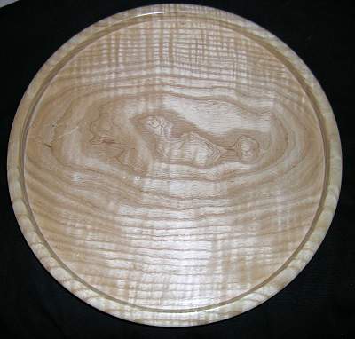

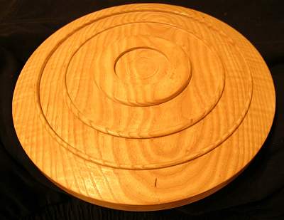

If you are not familiar with the speed of Shopsmith, be very cautious when starting up a new project. Even at the slowest speed (500-700 rpm) an unbalance piece can be extremely dangerous. I have tried to turn 10" hackberry half logs, and had to run for cover. I could not clamp it down hard enough with the drill quill using a faceplate, and press against live center. I stick with spindles and pends for now, and I'm looking for a way to reduce the speed to something around 70-100 rpm's; or getting a real dedicated lathe for turning platters and bowls. This platter was turned at the local club shop on a 16x42 Delta lathe (13" diameter flamed ash). Even as a balance blank, I'd be very scared to turn that on to start on the Shopsmith.

[quote="mgdesigns"]If you are not familiar with the speed of Shopsmith, be very cautious when starting up a new project. Even at the slowest speed (500-700 rpm) an unbalance piece can be extremely dangerous. I have tried to turn 10" hackberry half logs, and had to run for cover. I could not clamp it down hard enough with the drill quill using a faceplate, and press against live center. I stick with spindles and pends for now, and I'm looking for a way to reduce the speed to something around 70-100 rpm's]
Trying to understand the grain pattern. Was that cut from a trunk with a branch ring pattern near the center. Also is the 'flame' similar to fleck in oak(spanning annual rings)?

I don't know what part of the tree this was cut from, but the President of the Tennessee Association of Woodturners bought a plank (kiln dried) 14" wide x 2" thick x 10 ft. long, and cut the disk 13.5" diameter for me to turn. So different to turn kiln dried stick as opposed to green lumber cut with a chain saw. I need to get set up to turn the big stuff, because the spouse like them bowls and platters and plates. Great club to be a member of, and wonderful bunch of mentors to boot.
