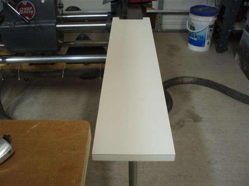

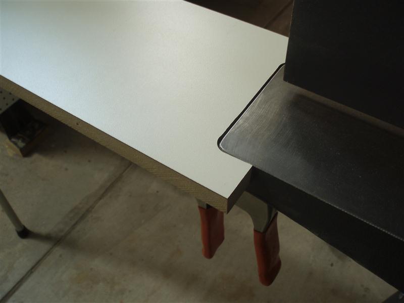

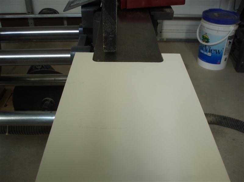

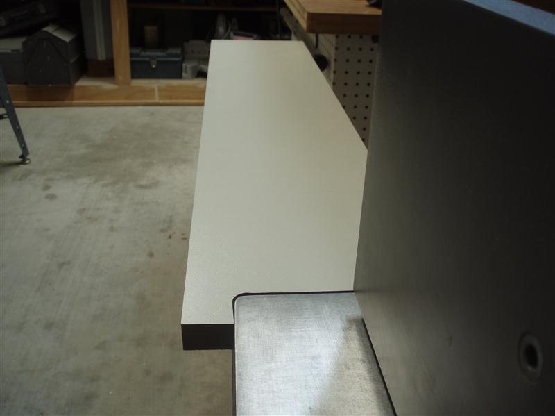

I'll see if I have pictures.
[ATTACH]16579[/ATTACH]
[ATTACH]16580[/ATTACH]
[ATTACH]16581[/ATTACH]
[ATTACH]16582[/ATTACH]
This application needs some modifications. The support leg is not as stable as it needs to be. I also need to devise a clamp that would allow me to get rid of that spring clamp.

These pictures do not do justice. The point at which the home made table mates with the outfeed table is, in my opinion, critical. You do NOT WANT a lip there that will impair movement of the work piece across the joint.wannabewoodworker wrote:Thanks Dusty that gives me some idea'ers!
Also equally important is the plane of the extension table. It must be absolutely in the same plane as the top surface of the outfeed table. If it is not, you will tend to cut tapers. It may not be noticeable but it will be there and you will become aware sometime during assembly.
NOTE: I did not say the table needs to be level. That would be true only if your jointer outfeed table is absolutely level.
I have been giving some thought to the adjustable legs and those thoughts have brought me to wonder about making them similar to the adjustable legs on crutches. Only instead of having holes in the center portion to cut a slot. Then the upper portion could be mounted on a hinge to the table. When not in use the legs could be retracted to their shortest position and folded out of the way for storage. Has anyone made anything like that? Sorry I do not have any pictures, but I have not progressed that far with the idea yet.
