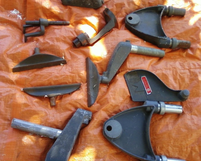

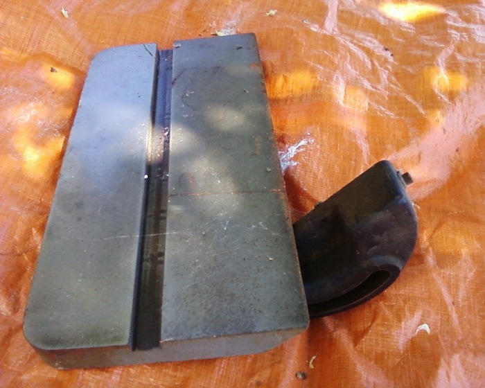

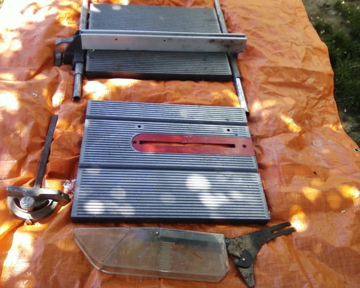

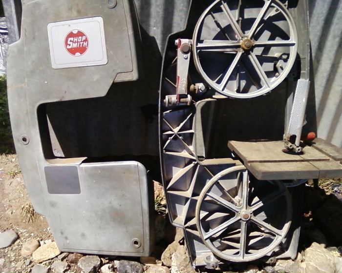

Well, I received a few more photos and the serial # (SS153386). Im hopeful he is still planning to send more as they do not encompass everything.
But 3/4 are of the additional pieces.
I have no idea what most of these pieces are for but thought you guys would easily recognize it.
If there are pieces that you are Not seeing that concern you please let me know. I havnt been able to tell from the pics if the drill chuck is there nor have I seen photos of the jointer or jig saw. I asked him to confirm he had them
Here are the photos...

I see a mishmash of 500 and 510 parts and what was probably at least 2 different Shopsmiths but not one complete Shopsmith. You've got two of some things you only want one of (two tailstocks, two lathe tool rest arms, two lathe tool rests) and zero of other things you want at least one of (lathe drive and cup centers, lathe tool set, disc sander, drill chuck).phillsam wrote:Well, I received a few more photos and the serial # (SS153386). Im hopeful he is still planning to send more as they do not encompass everything.
That 510 main table is taunting you because it is missing its trunnions and table posts and even if it had them it cannot be used with the existing 500 carriage as the PO probably discovered after buying those 510 tables.
The 500 rip fence is still awol.
The miter gauge shown is NOT Shopsmith and I doubt it will work in a Shopsmith (proprietary size bar).

That narrow table with the miter slot does not appear to be Shopsmith.
The band saw tires will likely be shot and need replacement. The band saw cover is missing its knobs.

Is the 4th picture a belt sander table? If so, find out if there is a belt sander hiding in this deal...
The 510 main table is useless without the trunnions BUT the two floating tables (with the fence attached) are good just like they are. I'll bet you could sell the 510 main table without trunnions, the two floating tables, the fence, the saw guards, and the connecting tubes for $100 easily.
For just the bandsaw, jigsaw, jointer I think it's easily worth $100 and I would pay $200 even if all were in the same condition as the bandsaw. Just know that each will require a restoration.
I do agree that you can probably find a better deal that suits your needs if you don't feel like putting in the work to restore it. It's not difficult to do anything on the shopsmith but it will take A LOT of time.
If it were me, I would buy it for up to $200 IF at least 3 SPT's are included. I would restore the SPT's and part the rest out on eBay. Parting it out is even easier if you have a good sand blaster. Doing this might let you recover all the costs for the original purchase PLUS any money spent to restore the SPT's. I would then find a more "complete" 510 or 520 with the standard accessories (drill chuck, disc sander, etc) and use this one in the meantime.
If I didn't have the time or desire to restore any of it, I would pass on this.

The band saw tires will likely be shot and need replacement. The band saw cover is missing its knobs. Lower tire missing - standoffs for cover knobs also missing.

An unknown is WHY the bandsaw mounting posts are still in the spt mount, and not in the bandsaw. Clearly the seller is unfamiliar with this stuff. That is a caveat!
