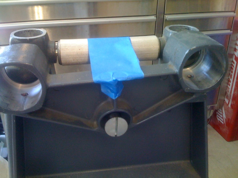

Ok.. I took apart the way tubes and removed the headstock.. Once that was done the way tubes came out of the far right end of the machine w/o problems -- apparently the set screws were not set -- probably part of my initial problem with the way tube lock not being aligned. Anyway, I've got the way tube end piece off and tried to align it with the large lock screw w/o having the tubes in the equation and you'll see the results below:
[ATTACH]1625[/ATTACH]
Is that about as good as the two of them pair together or is there something else wrong w/ my SS? FYI -- I'm using the blue tape to hold it in place while I used the camera.. I also have the adjustment set screw on the far right tub hole down all the way (this is the set screw that adjusts the height if needed)

Hi Rick! The alignment looks fin and dandy! It looks like you have the locking handle (hidden from view in the photo) is up (unlocked).
My unit is snugged up a little tighter than as shown in your photo. Every time I lower my my unit from the drill press position, there is a definite catch as the way tube tie bar slot comes over the adjusting screw. Maybe that is a little too tight, but it has worked that way for years.
P.S. Remember there is that little "Hex socket headscrew" (part no. 504153) that can be used to help align the extension table to both sides of the Mark V. This is an important little screw for that purpose, as many of us recently learned from Nick.
I really do not see a problem indicated in your photo.
If you are expecting the head rest to come down perfectly aligned on the locking bolt you might have an issue. But my sample of one does that much less satisfactorily than yours.

In looking at Dusty's last photo it looks like his sits a bit tighter than mine will, but that may be an artifact of the angle of the photo.. Anyway, I will proceed on ensuring all other pieces are nice and snug and put together right.. I'm sure I'll have other questions once I get back into it again..
