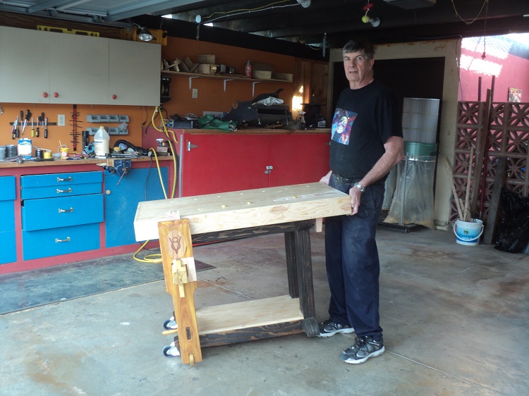

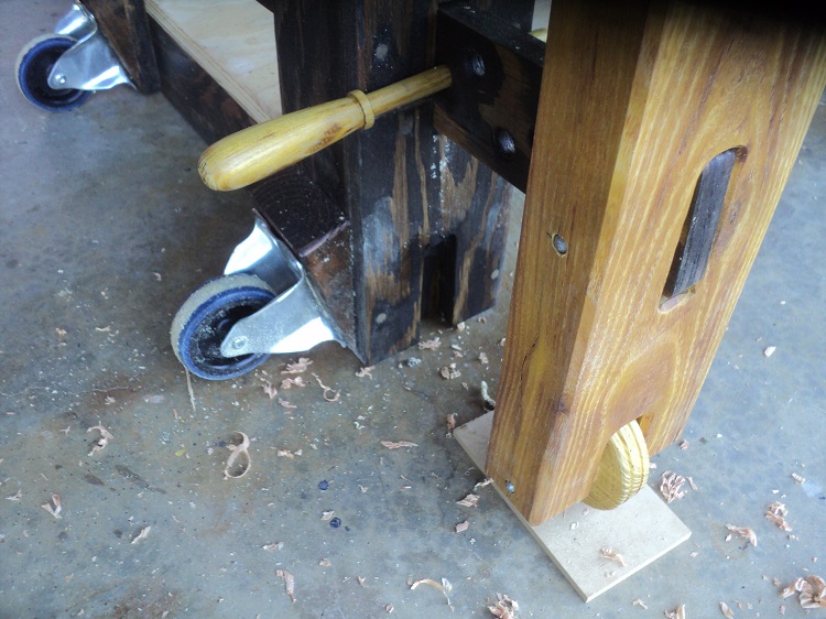

Here's a dead simple approach that I used on my small mobile bench in Az. It works great on a smaller size but would be a real bear if the bench is big.
[ATTACH]24768[/ATTACH]
[ATTACH]24769[/ATTACH]

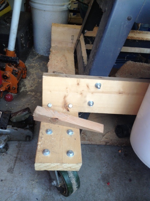

Regarding the wheels...
Post by teacherman »
You know, if you want to be hillbilly about it, I spent a rainy morning last year setting up my big table saw with some enormous casters I had lying around. It rolls so easily. The way I anchor it is that I screwed the four metal legs into a piece of 3/4" plywood that also provides me with a nice accessory platform as well as strengthening the legs. The wheels hold the plywood a half inch off the ground, and I have four wooden wedges I kick under the plywood when I use the saw, and I have found that two wedges hold it nicely, and four wedges are as though it were bolted to the floor. I will find a picture of it. Here it is. I know it's ugly, but boy is it ever sturdy and it rolls that two hundred pound sucker like nothing. My bench is lagged to the studs, but if I needed a rolling one, I'd incorporate something like this into the design, and find some big ol' wheels. I like it when heavy things roll easily! :cool:
a caster solution.jpg (105.15 KiB) Viewed 4044 times
"Wild Bad Bob"
Posts: 1065
Joined: Fri Mar 28, 2014 2:03 pm
Location: Germantown, Wi
Post by "Wild Bad Bob" »
I like how you did it with out raising the original height much, Thanks
I like the use of 'robust' materials:cool:, but would have positioned the wheels inside the horizontal 'strut' to preclude a trip hazard:eek:. Ain't monday morning vision clearer!:D
Anywho, nice thinking again!!!:)
