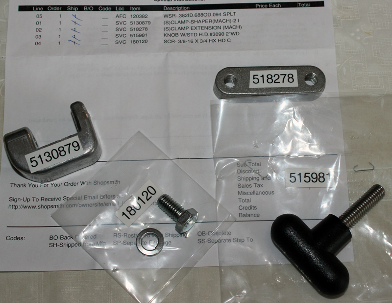

O< making progress. I received parts today, thank you, but am confused a bit. I got the following:
120382 - WSR-.382ID.688OD.094 SPLT (lock washer)
5130879 - (S)Clamp-Shaper (Mach)-21 (Clamp)
518278 - (S)Clamp Extension (Mach) (base with 2- 3/8" threaded holes to mount stand for guard and attach to clamp?)
515981 - Knob W/Std H.D.#3090 2"WD 2" 3/8" Bolt w/handle)
180120 - SCR- 3/8-16x3/4 HX HD C (Bolt)

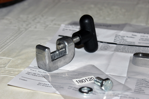

Not sure about the C clamp but I think it's missing a threaded 3/8 hole. I'm guessing that the "C" clamp has a hole bored and threaded for the "T" handle 2" x 3/8 bolt to clamp to the table. The extension has two threaded holes, one that holes the post that holds the plastic guard assembly as well one that I would guess is suppose to be used with the 3/8" x 3/4L bolt but there isn't a threaded hole on the topside of the clamp for it to blot to.
Hope this makes sense. Here's a picture of the parts, note the assembled "T" handle and clamp. How is the extension suppose to attach?

Re: Clearer Setup Diagrams/Instructions?
Posted: Tue Apr 05, 2016 6:31 pm
by Skizzity
That is great that you got some help. Looking at the pic...maybe?
Posted: Tue Apr 05, 2016 7:47 pm
by sreilly24590
Not sure what's on top of the clamp but yes, that's how I had it attached. The extensions doesn't sit sturdy under the clamp and there's nothing to do with the washer and bolt so my guess had it missing the threaded hole on top.

by reible
Skizzity wrote:Image
Without parts in hand and just going by the pictures here it looks like the clamp should have a second hole on the top side. The bolt would go through the clamp and into the clamp extender.
The 5130879 is not a order-able part yet. The 518278 is both a clamp extension and a part for the OPR????? Not sure what happened there. Anyway the extension is $5.18. The knob is $2.23.
With out a second hole in the clamp this doesn't make since to me.
Posted: Wed Apr 06, 2016 12:51 am
by reible
Well this was interesting. The clamp part is of course the same part as used on the shaper/sander fence for the model 500 table system. The part number is 513087. I decided to order one of these and while it let me order it the conformation comes back with 5130879, and yes that is the "new" part. Can't wait to see what I get.
The other odd thing is the part number 518278 as I mentioned it is the same part number as a part on the opr. If you go here:
http://www.shopsmith.com/ownersite/prod ... pgrade.pdf
And look for #8 an "insulator pad" so far the conformation is calling for a "Clamp Extension" so again it will be interesting to see what I get.
The knob looks like a slam dunk.
