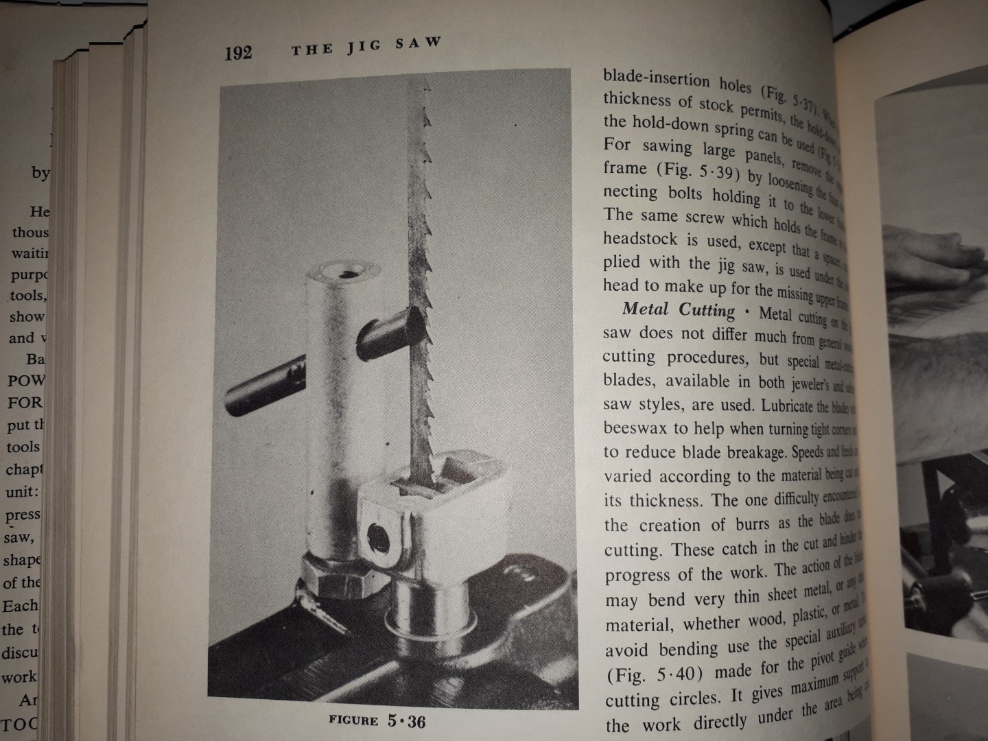

csxeng wrote:Thanks Russ! I appreciate the info that you and the other members have shared. Here are some pictures of the Jigsaw all done. The Jigsaw works very well! One puzzling question, How does the saber saw support (134-13) work, as I see a hole in the post and a adjusting jam nut. I don't see anything on what it does or how it's hooked up to anything even in the manual.
Dave V.
Here is a picture of how it mounts from Power Tool Woodworking for Everyone, 1st edition.

Thank you all for the wonderful reply! I was scratching my head wondering if that bolt was the OEM one that should be there or not. I guess my friends father either broke or lost the original bolt. I will most likely use the one off the extra 10ER that I have. Thanks Ron for the picture of the saber saw support. Now I see where it goes.
