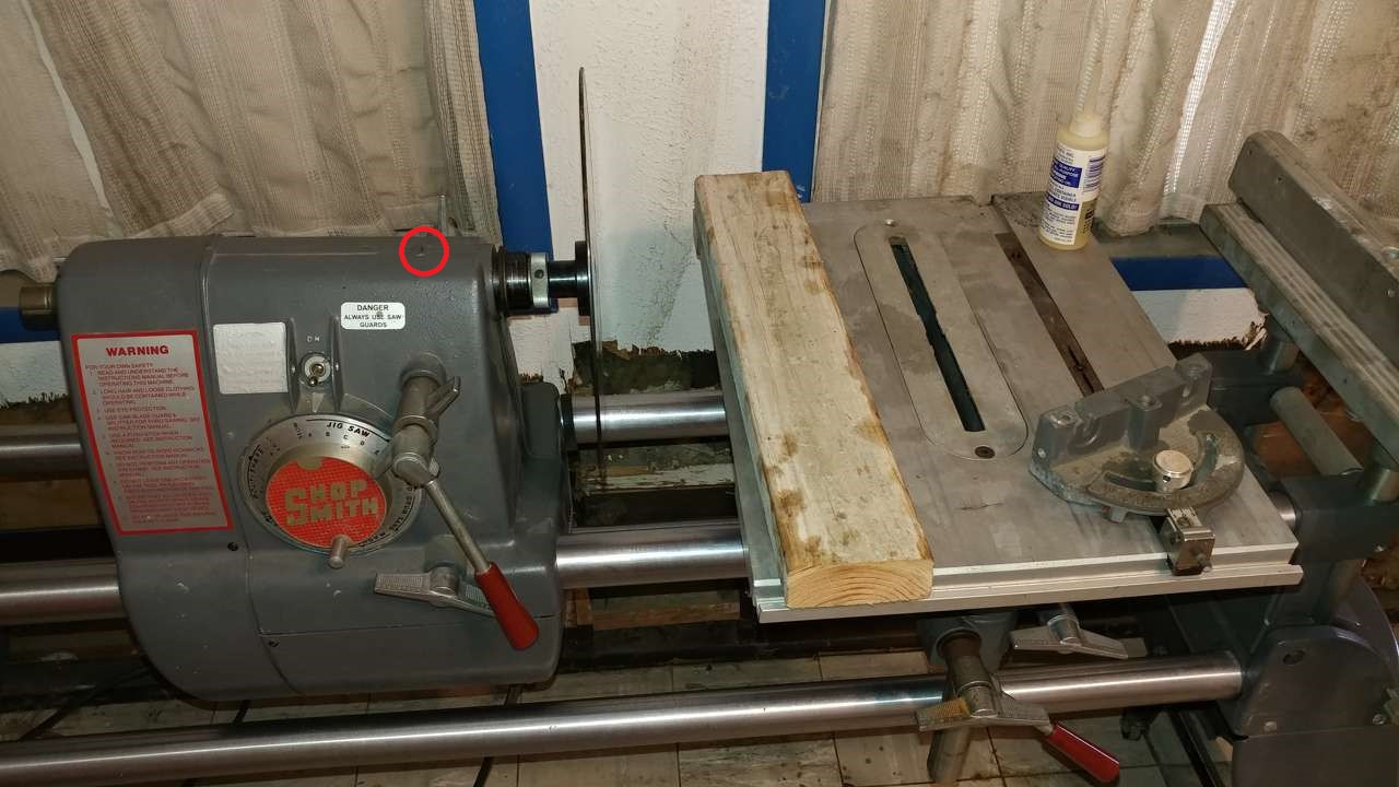

ehbowen wrote:Note: The quill extension is very, very stiff; at first I thought it was frozen even though I released all locks.
Since you are new to SS there are three easy mistakes, best to look at those first. You mentioned locks, plural, so probably not the first two: loosen the Quill Lock in the front and the Feed Stop in the rear. Next is make sure this setscrew, circled in red, is not fully seated:
Guide setscrew
Guide setscrew
Loosen it slightly, 1/8 turn, and see if it frees up the Quill. If that is not it, it becomes slightly more complicated. I'd say start a new thread under Maintenance and Repair but first review this recent thread: https://www.shopsmith.com/ss_forum/main ... 23456.html

Okay, that setscrew didn't help; I loosened it almost a full turn and the quill is still stiff. I didn't recognize it as a setscrew at first; it was covered by a plastic plug. Then I saw what seemed to be a similar setscrew on the back of the headstock above the assembly to set the quill feed limit and I tried loosening that. Mistake; it looks as if it was for a spring to counterbalance the weight of the quill in drill press mode...the stop indicator made close to a full turn when I loosened it. So now I have something else to fix.

The set screw on top of the housing is covered with putty from the factory. If the putty is still there as you suggest it is unlikely the screw is out of adjustment.
The quill rack and pinion along with the quill body and the housing are likely gummed up and causing the problem. Remove the quill and thoroughly clean everything. Then wax the quill and the housing with Johnson's paste wax. Do not use oil or grease. It collects saw dust and creates the problem you are seeing.

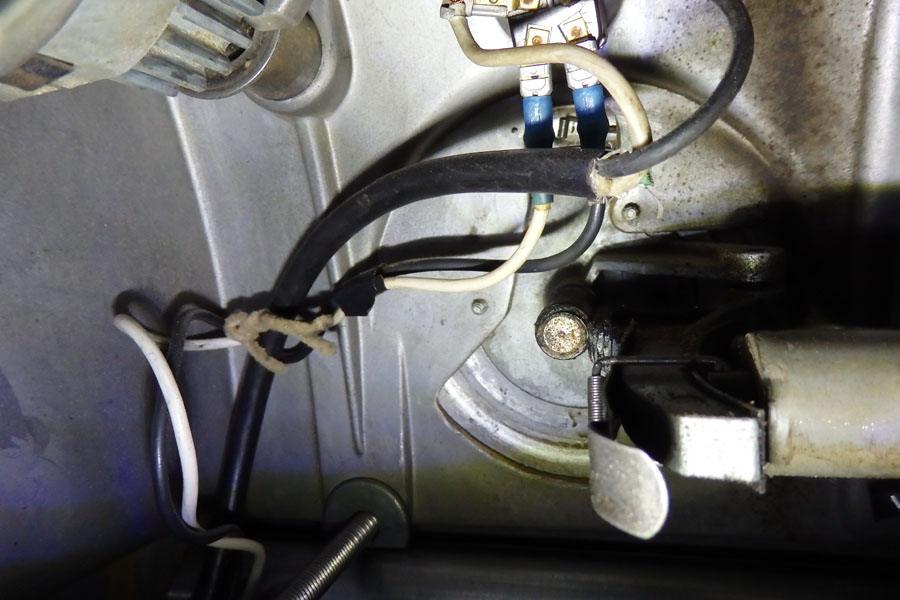

In order to get the quill pinion out I had to take out the speed control assembly and that was a bit of an adventure. I think I finally managed to get everything set back up correctly and a high speed adjustment done (thanks to the links in the Maintenance & Repair section), but I'd feel more comfortable if I had a tachometer to check it.
I did get all of the recommended lubrication (re)done while I had the headstock open, and As Far As I Can Tell everything in there seems to be undamaged (although a couple of the quadrant teeth look a little bent...not badly, though). There was one loose item which I couldn't identify, a white plastic strap a little over an inch long which looks like a restraint for electrical wires. Where is that supposed to go?

The little white strap that you mentioned I seem to recall, but when I went out to take a picture of mine, I don't see it. Perhaps mine broke and I just removed it. I do think its only purpose was to hold the wires out of harms way. I do that with a twisted pipe cleaner and a little electrical tape, tying the individual conductors to each other and back to the main cord.
