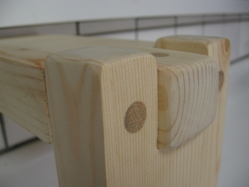

Some of you might have seen the design I did in Sketchup in the Sketchup 101 thread here. I've put together a couple prototypes of the joinery. My first attempt didn't come out very good at all. I used hardwood of an unknown type, about 1/2" thick by 3" wide. The fingers fit together much too loose.
I tried it again today using pine 2x6 leftover scraps from a picnic table that I ripped down to 4" wide. Much better results this time and I like the way the joinery looks using the thicker wood. But, I still have a way to go. I abandoned the square plugs deciding that was beyond my capabilities right now. Forming the square plugs and the square holes would be entirely hand tool work (I don't have a hollow chisel mortise) and I need a lot more practice for that. Drilling a hole and using a dowel is within my range of abilities.
[ATTACH]6832[/ATTACH]

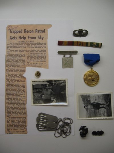

Also, I wanted some feedback on the layout of the medals for the case. This is what I have. I'm using what I have for now although I'd really like to put in a rank patch if I can get one in time.
[ATTACH]6833[/ATTACH]
The newspaper article details a firefight my dad was involved in. Mom gave it to me with some other stuff she had. I thought it would be interesting to include it to give the display a more human element. Based on pictures I've seen, the medals should be laid out pretty close to how they are worn on a uniform. Can those of you with experience verify if I have that right?
