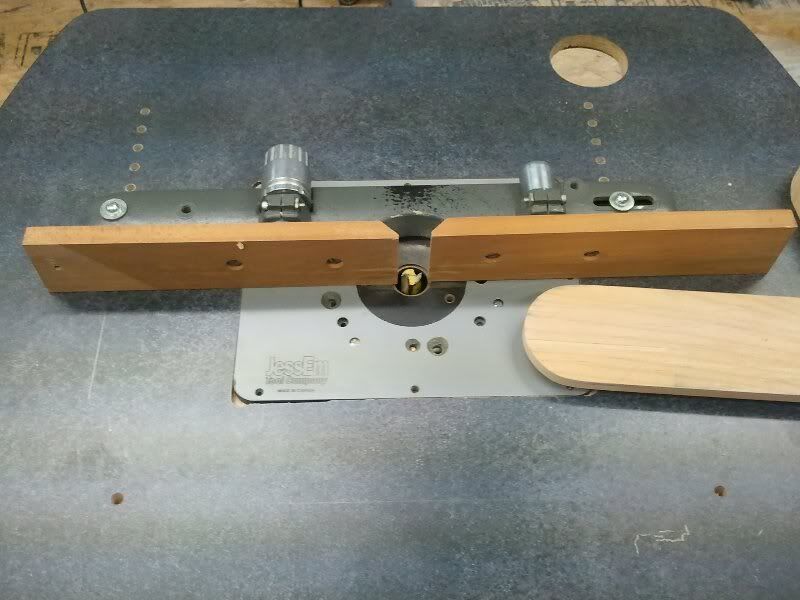

I got the top of my router table done today. I took a lot of influence from the first article pennview linked to in post #2.
I still haven't built anything below the top. I don't know yet if it will take up its own floor space or if I'll pull it out and set it on something else when I want to use it.
I made a couple cuts with it sitting on my trash can and have realized that a dust collection port is going to be a necessity.
Other than dust collection, the Shopsmith fence works out pretty great.
