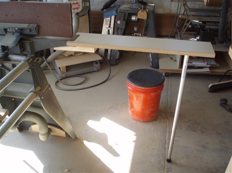

JPG40504 wrote:Yes, thus far I have been using the telescopic leg and a roller stand would definitely be more stable.
I am considering a hinged leg to replace the telescopic one. The nice thing is that the leg can be of fixed length. I use the jointer mounted on the Mark V and therefore the distance to the floor is constant.
My current concentration is on developing the physical interface between the jointer table and my version of an extension table. Once that is finalized, the leg will be a snap.
Until the idler shaft eccentric is adjusted for belt tension.]
How often do you think I'll be adjusting the eccentric enough that I will have to readjust the jointer. So far it has only been when I rebuild a headstock - once.

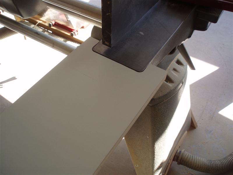

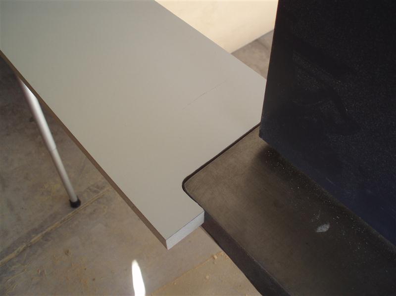

I have eliminated the spring clamps that were once used to attach my jointer table extension to the jointer table.
Due to a screw up on my part, the table is 6" shorter than it was in the beginning but it is now attached using a cantilever arrangement and no spring clamps.
I am still using the telescopic leg but the revised manner of attachment is many times more stable.
[ATTACH]16638[/ATTACH]
[ATTACH]16639[/ATTACH]
[ATTACH]16640[/ATTACH]
Jointer Extension 001 (Custom).JPG (63.42 KiB) Viewed 9624 times
Jointer Extension 002 (Custom).JPG (35.66 KiB) Viewed 9621 times
Jointer Extension 003 (Custom).JPG (45.09 KiB) Viewed 9621 times
