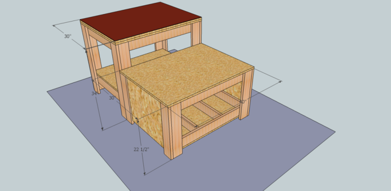

Any reason a lag screw couldn't be used for a leg leveler? Pre-drill, of course, then screw it into the bottom of the leg. Adjust the depth of the screw to adjust the height of the leg.
I have an idea of how to do dust collection for the table saw, but I haven't put anything into Sketchup yet.
I've got my parts list made out for both the saw cabinet/outfeed table AND for a Norm Abram "New Yankee Workshop" type workbench (sans vice hardware). Still trying to talk SWMBO/LOML into letting go of the money...
Heath

A lag bolt would be a budget solution, but i question the durability and the whether they would 'drift'.
I think a bottom plate on the leg with a tapped hole that a caster threaded stem mates to and a jam nut would be preferable. If not a caster, then a cap screw. The plates are available, or you could make them from scratch.

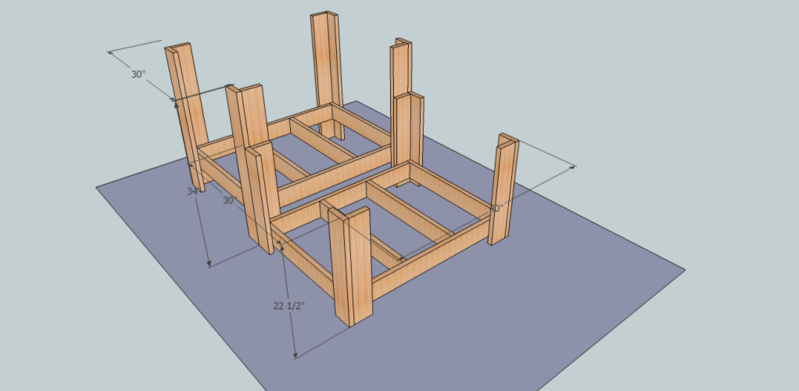

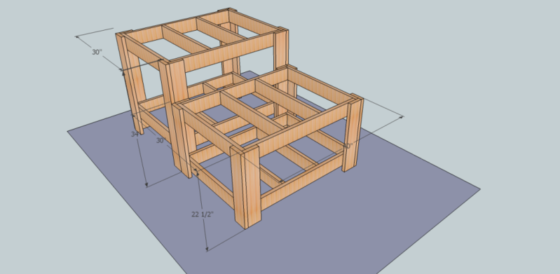

Back to the drawing board
Post by heathicus »
After sleeping on it, I decided I should go back to the drawing board, and scale this back a little bit. Make it a little less expensive and a little more simple.
I don't have any more 2x lumber that my dad gave me to build my shop, but I have plenty of 1x lumber. So instead of buying new 2x4s, couldn't I use my stock of 1x4's?? Then all I would need to buy is the sheet goods.
So, here's what I came up with.
Instead of drawers under the saw cabinet, just one open area for storage of small cutoffs.
Any obvious problems with this?
Heath
Central Louisiana
heathicus wrote:After sleeping on it, I decided I should go back to the drawing board, and scale this back a little bit. Make it a little less expensive and a little more simple.
