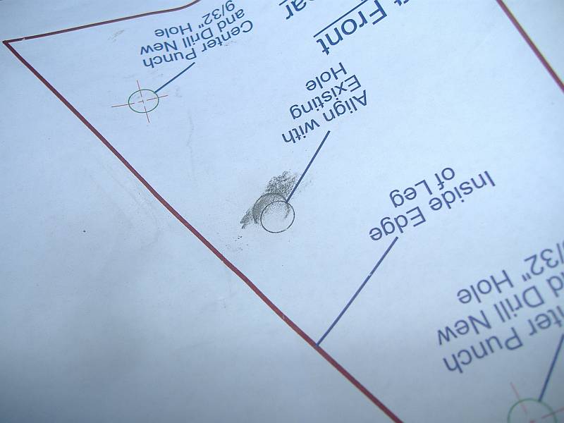

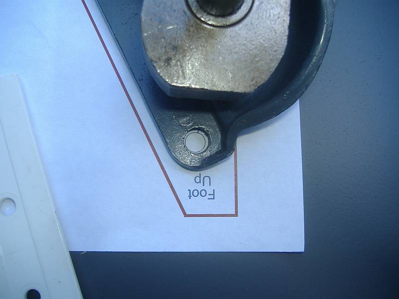

I did not use the shopsmith template. At least for my vintage hardware the template is not correct. I have no idea about newer hardware. AND I'm not talking of the height issue, this is a new one that I found just today.
First here is a shot of the casters on the shopsmith template, hole centered on template hole.
[ATTACH]17162[/ATTACH]
Now we go to the other end and it is quite easy to see the template and caster spacing do not agree.

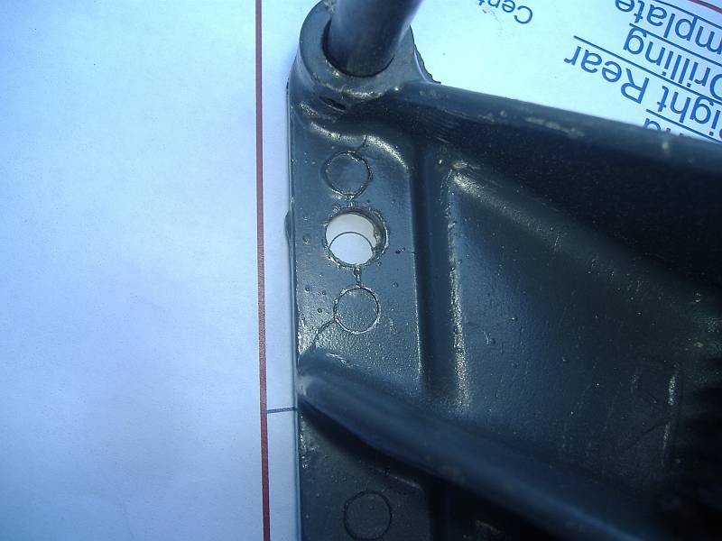

Now I checked the legs to see how close that might be....
[ATTACH]17164[/ATTACH]
Old hardware vs new hardware or a shopsmith error????
Any way the old caster and old legs have the same spacing and that is what I used rather then the template information.
[ATTACH]17163[/ATTACH]

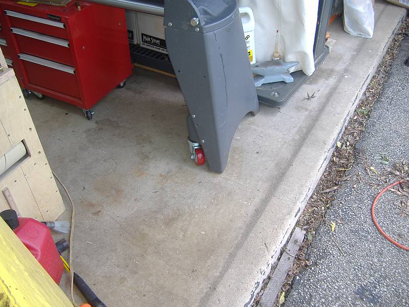

Question on Shopsmith on new casters
I see in the photo that you have to clear a step and a gap to move the SS to the driveway. Can you do it with just the casters? or you hand lift it or use other method?
I have the regular casters and for me is a major challenge to get my SS to the driveway which I must as my garage is full.

eartigas wrote:I see in the photo that you have to clear a step and a gap to move the SS to the driveway. Can you do it with just the casters? or you hand lift it or use other method?
Hi,
Looks like you may have come into the thread part way through, no problem, just go back to the first post and you can see my ramp.
I don't know about your driveway but mine is not very smooth, I'm interested in seeing how the new casters help with that. Should be able to install the set on the other end today and find out.
I now have the caster upgrade on both ends of the machine. This time I did it from the outside of the leg. Alignment and lift all work well.
Rolling the shopsmith around on the smooth cement garage floor is easier but not so much better that I'd get excited about it. Outside on the driveway which is a very ruff roll I'd say it is somewhat easier but again not so excited about it at least at this point.
Given the vintage of my equipment the templates were less then wonderful. Had I followed them I would be very unhappy. I need the 1/2" clearance for the driveway, 1/4" will not work.
