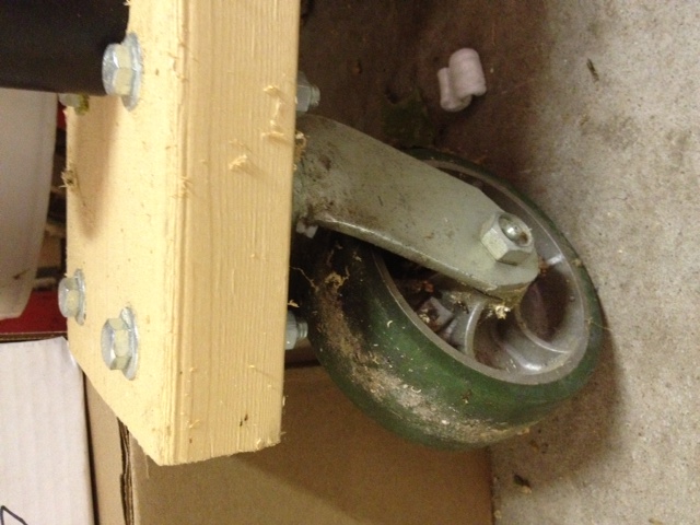

However, these old old casters with ball bearings and grease zerks have started to lose the plastic "tires," so now it rolls badly again. I think I will be able to use my alternative-American engineering to come up with a solution. Maybe JB Weld to fill in, or spacers and smaller Harbor Freight wheels.
I did REALLY like how easy it was to roll that thing, since the original wheels would scrape and not roll, no matter how much I lubed them.

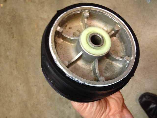

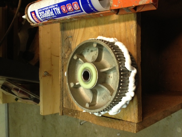

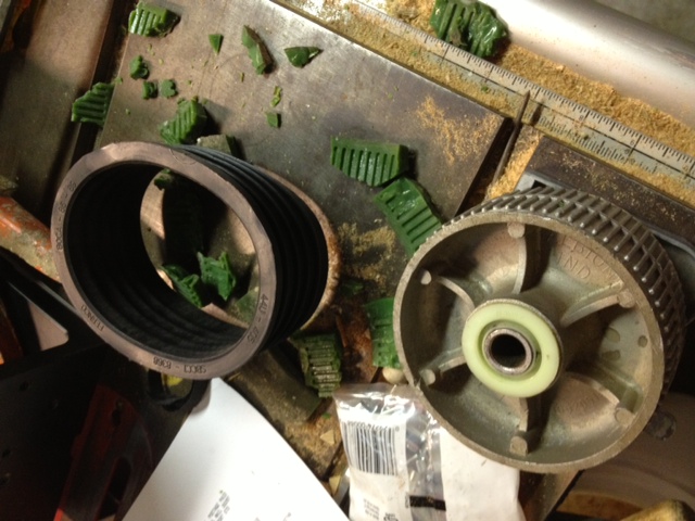

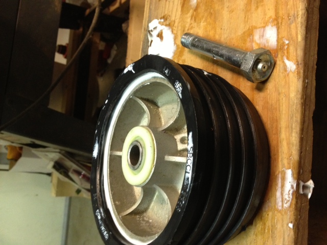

They're aluminum. Thinking outside the "box," whatever that is, has yielded what I think will be a good result. Alternative American Engineering, I call it. A fernco 4" coupler will do the trick, with some Polyseamseal caulk and some trimming. Pics tell it best. The last one shows what I'll trim off when the caulk cures. The first one shows a good wheel. Note the grease fitting in the axle, it has double needle bearings in the wheel. and the directional bearing are zerked as well. The diameter is close enough, and the ridges will eventually wear off if they need to. About 8 dollars.
