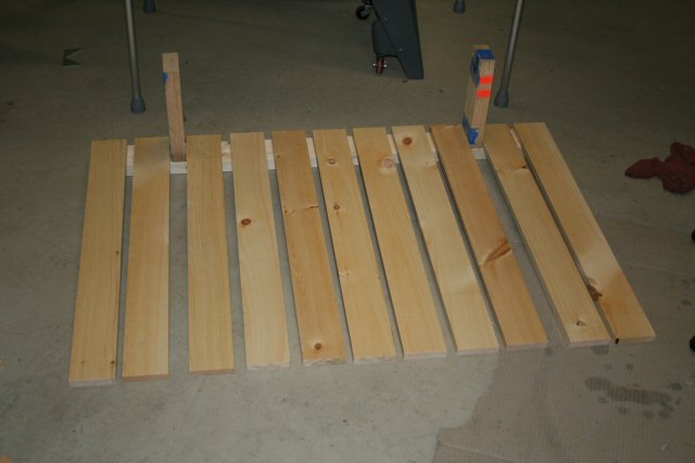

I snuck downstairs this morning to sneak a bit more progress in before I had to get to work. First, I had to decide where the support posts would be relative to the shelf planking. Here is the rough arrangement I decided on:
[ATTACH]1388[/ATTACH]
I wanted the supports to be far apart enough to be able to place long/bulky items onto the shelves, but not too long that the 2x4s will sag in the middle. The arrangement above seems good to me. The shelves will not be used to store heavy items, so I am going to proceed with it.
Next I needed to perform some computations to determine the gap between the slats. To do this, I need to know the total amount of open space, and the number of open spaces it gets spread across.
  • The workpiece is 48" long.
  • There are 11 slats, each 3.5" wide. Subtract 11*3.5 = 38.5".
  • There are two vertical 2x4 support posts, each 1.5" in width. Subtract 3".
  • The total gap is 6.5". There are 8 gaps I want to spread this across, so the gap between the planks is 13/16".
Now, how far in must the dado be from each end of the 48" piece? Well there will be two slats and a gap, so that's 7 13/16" from the end to the outer edge of the dado.

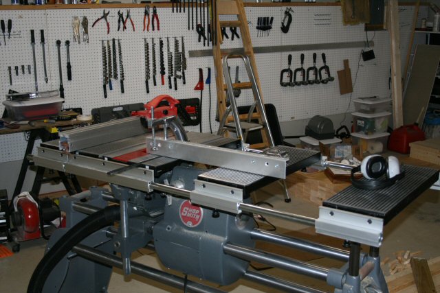

Here's a picture of the Shopsmith setup for dadoing:

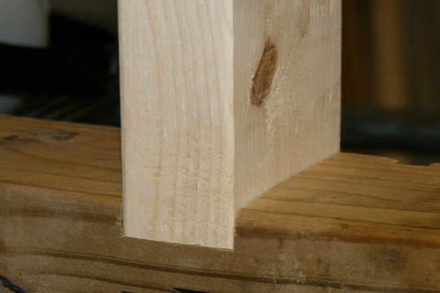

Here's a picture of "My First Dado":
[ATTACH]1390[/ATTACH]

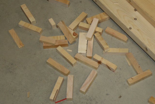

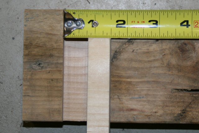

My dado stack is set up to cut a 13/16" wide dado. Now, I wanted to go with the two-stop method of cutting a 1.5" wide dado. To do this, I needed to know how much further out the second stop needed to be. Of course, by the numbers this would be 24/16" - 13/16" = 11/16". But, I took a look at the pile of scraps from trimming the planks to length:
[ATTACH]1391[/ATTACH]
I could use one of these scraps as an extra stop in addition to my primary stop. In essence, the dado becomes wider by the width of this extra stop. All I really needed to do is to find a scrap in this pile which - when combined with the current dado width - puts me at my target width.
Ah ha, here's my man!
[ATTACH]1392[/ATTACH]

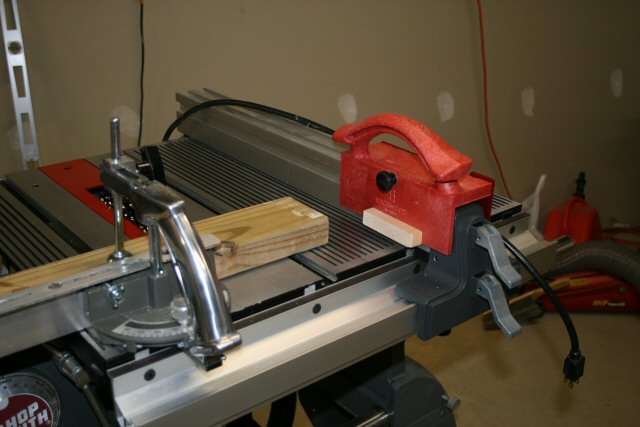

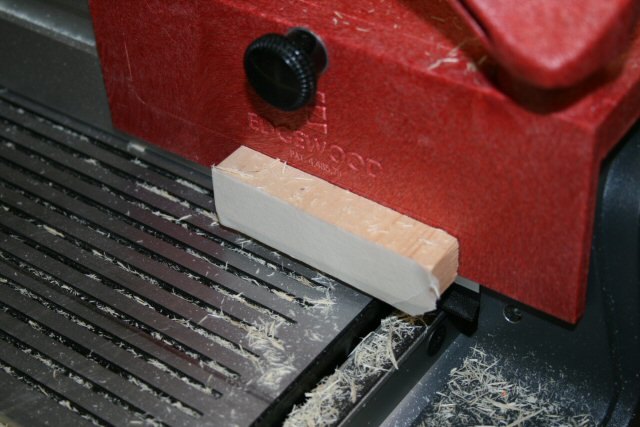

I noticed that with 2x4s, I couldn't use the fence-mounted featherboard as a stop (the knobs were in the way) so I used this other fence-mounted thingy instead. I cut a couple pieces of double-stick tape and stuck my second stop block to the red thing which will be my primary stop block. I then positioned the rip fence so the second stop block measured 7 13/16" away from the closest dado tooth:
[ATTACH]1393[/ATTACH]
I know it looks like the width of the stop block isn't consistent, but I actually just taped it on the red thing crooked.
I took a longer test piece and ran it through twice, against the first stop and second stop. Then I took one of my 2x4s and tried test-fitting the end... did I get it close? here goes...
[ATTACH]1394[/ATTACH]
Wow, it fits! It's not tight, but it's not loose either. It basically slides in with slight contact on both sides. Since the joint will be further glued and triple-screwed, I think this will work out perfectly.

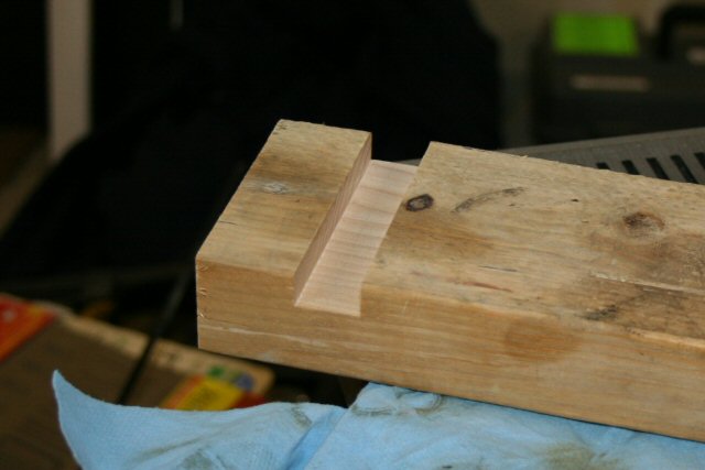

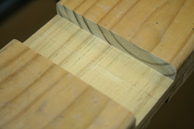

In the dado I double-cut, I noticed a groove on the dado floor:
[ATTACH]1395[/ATTACH]
This seems to be due to the outer dado blades cutting slightly deeper at the very end. I remember reading about this, but I didn't think about it until now. It won't affect this joint, but it was interesting enough to take a picture.
When I checked to make sure the dado was 7 13/16" away from the end, I noticed it was about 1/16" too far. I unlocked the rip fence and nudged it 1/16" towards the dado, then locked it back down.

chrispitude wrote:..................I wanted the supports to be far apart enough to be able to place long/bulky items onto the shelves, but not too long that the 2x4s will sag in the middle. The arrangement above seems good to me. The shelves will not be used to store heavy items, so I am going to proceed with it...................
Hi Chris,
It looks like your first real project will be a success! Let me tell you, you could put a couple of engine blocks on those 2X4's and they still wood not sag. Might pull the ceiling down, but they wood not sag.:D

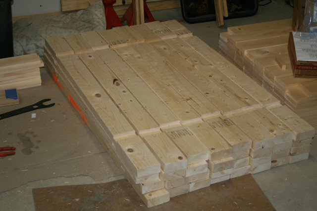

I finished cutting all the dados:
[ATTACH]1406[/ATTACH]
I got into a pretty good rhythm. The two-stop method absolutely makes this a more efficient process. Two dados on one side, rotate 180, two dados on the other side. I had to really pay attention to make sure I only rotated end-for-end, and did not also flip and cut the second dado on the wrong side. I was surprised how much a dado cut was affected by knots in the wood, but I guess I am not too surprised.
Each group of four workpieces represents a single ceiling-mounted shelf. For each group of four, I laid them out ahead of time and chose their orientations depending on which wide I wanted to present for view. In this way, I was able to hide knots, ragged edges, ink stamp designations, etc. from view without any great heroics. I'd lay the set of four on the floor with the side to be dadoed down, power up the Shopsmith and cut all four boards, then power down and bring the next set of boards over.
Quick note - this much precision is absolutely not needed for this simple project. However, this is my first project and it's a good opportunity for me to learn how to cut with good precision so I have a better handle on it when it does matter.

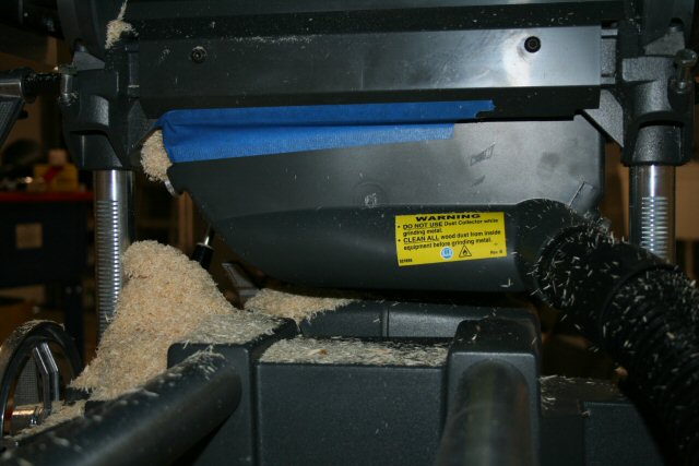

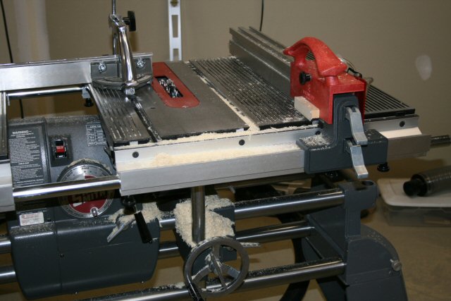

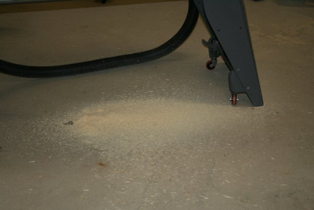

How did my Shopvac stack up for dust collection? For dado cutting, not very well I'm afraid:
[ATTACH]1407[/ATTACH]
[ATTACH]1408[/ATTACH]
I have to admit it seemed like I didn't even have the thing hooked up. This is unfortunate.
I even tried closing the gap in the lower guard to help keep sawdust in the guard area:
[ATTACH]1409[/ATTACH]
You can see in this picture that most of it is being thrown out of a small hole/gap near the front of the lower guard. The dado seems to cut larger chips of wood, and the chips carry more momentum as they are thrown such that the dust collection airflow can't grab them before being thrown out this hole. I guess I am just not really too impressed with this lower guard, although maybe my problem is still insufficient airflow.

If you really want to know how effective your dust collection is make a few dado cuts in the wood without the vac. I assure you, you collected 95+% of the dust.
Before I had a dust collector I made a bunch of dado cuts in some wood. When I finished I was knee deep in dust. Even now I use my RAS which I don't bother connecting to a my dust collector. After cutting a few boards I have as much dust as you do after making all these cuts.
Don't sell your dust collection short it seems to be working, I don't care what machine you have or how powerful the dust collection you will always have some dust escape. That is just the nature of woodworking.

Golly, this 8" dado stacks is heavy. I swapped out the saw blade table insert for the never-used dado insert and removed the riving knife. I raised the table and pulled the headstock to the left and removed the saw arbor and attached the dado arbor. Did I mention the dado stack sure is heavy?
Two things come to mind. 1) turn the speed to slow before shutting down, so you won't stress the motor or blow a breaker. 2) I hope you have a two bearing quill with all that weight bearing down on it.
chrispitude wrote: You can see in this picture that most of it is being thrown out of a small hole/gap near the front of the lower guard. The dado seems to cut larger chips of wood, and the chips carry more momentum as they are thrown such that the dust collection airflow can't grab them before being thrown out this hole. I guess I am just not really too impressed with this lower guard, although maybe my problem is still insufficient airflow.

Yep! you hit the nail on the head! Insufficient air flow is your debris problem! When you checked out your shop vac, was the filter covered? Those things aren't designed to suck up big volumes of stuff. Even though it may be 8 gallons or so,( it'll easily get 5 gallons of water), but with sawdust, the smaller chips plug up the filter, hindering air flow. Dont blame the lower saqw guard!
