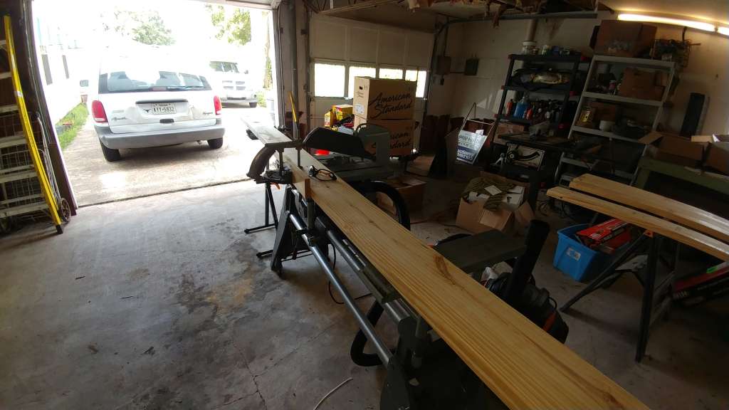

First step is to crosscut one of the 2x6s and both 2x4s in half. The 2x4s will be cut to match the roof line later; my plan was to resaw the 2x6s into thinner boards...front and rear end caps, and some to just mount on the top of the box to keep stuff from flying out. Here I am with the Shopsmith ready for First Wood (well, under my ownership at least!)
Shopsmith Mark V/500 set up for crosscutting
The roller stand is a cheapie from Northern Tool. Dust collection is being handled by a Ridgid shop vac in line with a Dustopper. First thing I noticed is that the saw blade binds very easily. I had to hit the switch several times and regroup. Probably would have been a good idea to get help for crosscutting a 10' 2x6, but I had no help readily available. After pray-and-try-again (gently) a few times I got the 2x6 cut. For the 2x4s I re-evaluated my setup...I followed the instructions in the book to minimize the blade clearance over the piece; I had maybe 3/16" projecting. I lowered the table so that the blade projected about 3/8" and the 2 2x4s cut much more easily.

My $0.02: That's a long board to try tp cross cut using the miter gauge even with an auxiliary fence on the gauge. Any slight drag at either end is going to impart a lot of sideways or angular force against the blade, so I'm not surprised it was binding.
For something that big, you really should have a cross cut sled with some good hold downs to keep the board down on the slde and against the rear fence of the sled. By having it on a sled, you won't get so much tendency to drag/twist/bind.
Good luck!

Sounds like a plan. In addition to the side rails, which will need to be trimmed to 8' 6", I have another project in mind (new garage doors) which will require several 8' cuts to exact length. I've never built or worked with a sled before. Where might I find information on building one which will work with a Mark V/500?
Re: New to the hobby; looking for tips
An alternative/work around is to use two miter gauges(one on each side) and use the clamps(manually clamped[old style]) so one can merely push the workpieces and not have to squeeze the handles. That provides guidance on both sides of the blade.
re the sled, with a M5 smaller table AND the two miter slot extenders you have greater slide range before the blade contacts the work piece..

No one has mentioned it yet, but in your excitement of using your new tool, realize your Shopsmith may not always the best tool for a given task. To cut 10' 2 x 4's or 2 x 6's in half, I would have simply used a hand saw or a circular saw. A sturdy sled may also work, and it has it's uses too. To see others' versions of sleds, just do a search for crosscut sled.
I once thought I could cut dadoes to recess some shelf standards in some 12" x 80" pieces of plywood, and do it by myself. Quickly ruined the plywood as the piece was too unwieldy to control. Today I would use a router with a straight edge. With practice and a few mistakes, you'll get better. Just always remember to work safely, and it's only a piece of wood.
For getting exact lengths, if the piece is too long for a crosscut on your Shopsmith, then cut slightly long and then use disk sander to fine tune and get good square end.
