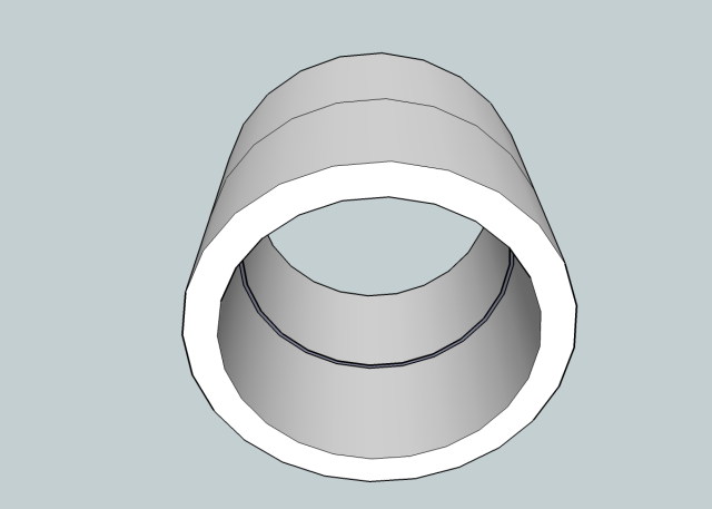

PS: An attempt at drawings.
[ATTACH]5756[/ATTACH]
This drawing is intended to depict the relationship of two rail sections (abbreviated length). The two segments have ODs of 1 1/4" while the IDs are 7/64" and 6/64". My extensions tubes are a nominal 1" OD with a wall thickness of .065". The gap between the extension tube and the inside walls of the two table rails would be 1/32" on one and 1/64" one the other. The extension tube, when locked into the rails would be forced outward to the point where the outer surface would be forced against the inner surface of the rail with the smaller ID. This would leave a gap of 1/64" between the extension tube and the inside surface of the other table rail (the one with the larger ID).
What problem(s) does this create?
Two Rail Segments with Same ODs and Different IDs.png (55.87 KiB) Viewed 4515 times
dusty wrote:Can this offset not be compensated for by shimming the standoffs where they fit against the machined pads on the mating table. That is, move the entire rail out away from the table by an amount equal to the offending offset.
If this is done to every offending rail, the outer edge (circumference) of every rail would be inline with one another.
Drawings or photos would sure help!
The two 'varieties' should have the same dimension over all(assuming the table 'depth' and the spacer 'length' and tube o.d. are the same. They would vary only by manufacturing tolerances which IMHO should be far less than 1/64". I am assuming that your attempts were to shim the spacers so that all the table rails have their outer surfaces aligned.(with 510 hardware) This alignment of the OUTER surfaces of the table rails IS desirable regardless of whatever tube variations one might have.
That WILL work if all the table rails ARE the same wall thickness.(their manufacturing tolerances should be very small).
Therefore the only thing different between the two varieties is the location of the inside wall. The thicker table rails will have their 'reference' wall 1/64" closer to the table(the reference wall is that portion which the extension tubes contact when tightened into place). This reference wall is what aligns the tables to each other. This is why 'bent' tubes are a problem.
I had first thought shims were the 'answer', but I overlooked the resultant expansion of the outer (front to rear) dimension which would affect the positioning on the curved 'pad' on the fence(sets on top of the rear rail) and the clamping(rear) tension adjustment.
Since the ONLY difference IS the location of the 'reference' wall it needs to be brought into line with the other variety. Shimming the inside of the 'thinner walled' table rails seems the only logical/practical(?) choice.

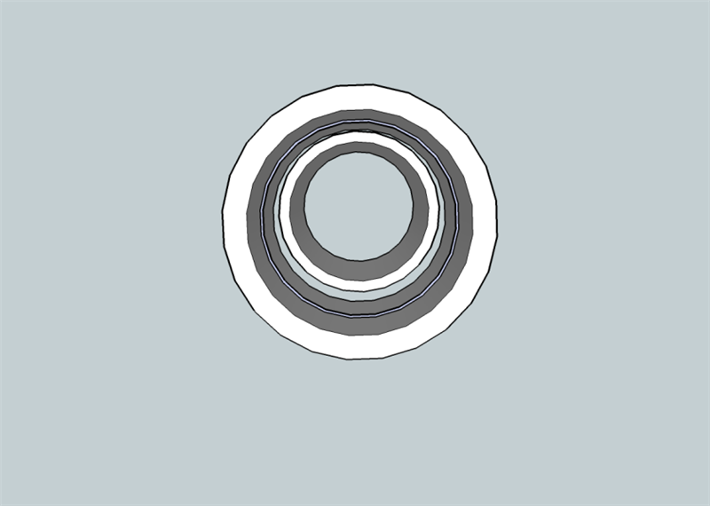

Another attempt at expressing the situation as I see it.
[ATTACH]5757[/ATTACH]
Two Rail Segments with Different IDs and Same ODs and Extension Tube (Medium).png
Two Rail Segments with Different IDs and Same ODs and Extension Tube (Medium).png (78.61 KiB) Viewed 4415 times

When the OUTSIDE surface of the table tubes(rails) ARE aligned, there is NO problem. However they do not stay aligned when the extension tubes are inserted and tightened. They will stay aligned only if the thinner table tube is compensated for. If the 1/64" to 1/32" misalignment does NOT affect your work, then there is NO problem. If it 'gets in the way' of 'getting the job done' then there IS a problem.(aggravation of difficulty of sliding fence across the 'joint' and the 'cocked fence')
I think Keakap has the experience of trying to 'put up with' this due to the circumstances relative to his table replacement. Wonder what he did with the old table rails. Longer screws and nuts would allow putting the older(thicker) table rails on his 'new' table.
