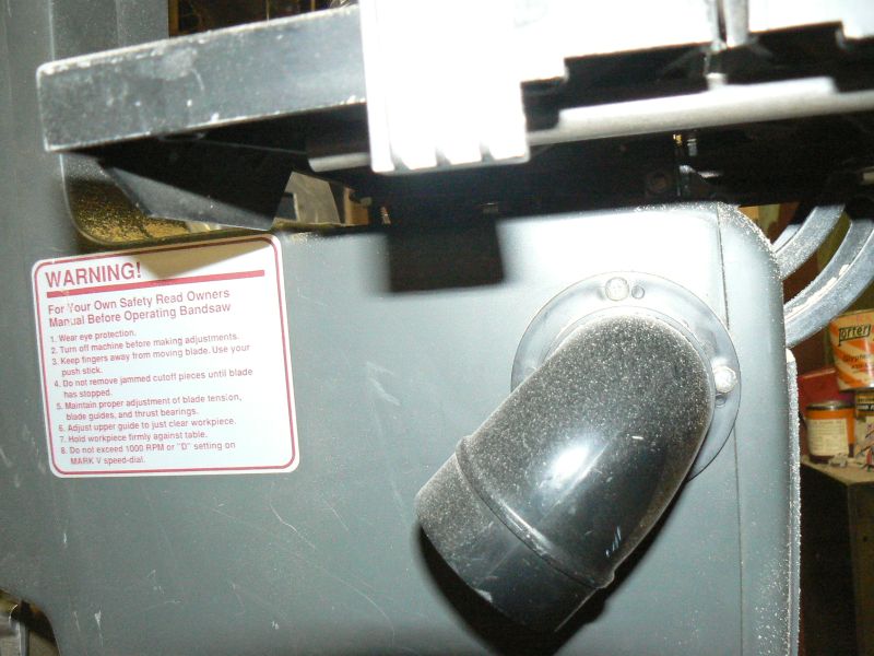

putttn wrote:I received a email offer to purchase the side cover for the bandsaw at a discount from SS but the links to SS don't work. I don't seem to be able to access their website at all. Anyone having the same problem?
I assume that whoever added this port did so in the correct location.
[ATTACH]8582[/ATTACH]
BTW I do NOT have a DC!:eek:
P.S. It appears I 'quoted' the wrong post. Oh well at least it was the same 'postee'!
- band saw dc port.jpg (98.44 KiB) Viewed 4028 times
