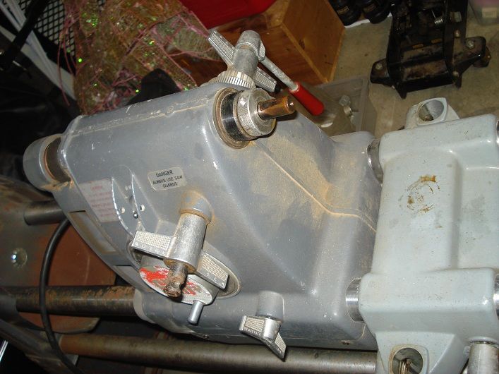

2rr2nv wrote:Wish I had a gear puller that big. have em but not THAT big. I think we might be heading out for some stuff so I may be able to pick up some better penetrant. may give the hammer tap a try too.
Thanks ya all.
Scot "Z".
and here are the latest pics messing around with installing whatnot and trying out my polishing skills on the uprights...

Thanks ya all. Good to hear about the arbor and puller setup. was worried that the arbor might get damaged by the puller feet.
quite pleased about the polishing and glad ya think so. I know it won't ever be at the level of some of you guys, but I would like to get at least to the level of factory crosshatch pattern.
Scot "Z"

Excellent news!!
a combo PB blaster and my ole trusty gear puller did the job!
WOO WOOT!!
Now onto more servicing...
Scot "Z"

So, what is the rule to keep this from happening again ?
beatnik wrote:Great !
The Rule?? I don't know that there is a rule; however, in my shop the items that mount on the spindle come on and off so frequently that rust doesn't have a chance to form.
So---
A rule might be to frequently dismount those items that attach to the spindle.
I'm glad that you got this taken care of without doing any damage.
What Dusty said!
And JPW!!!!! Quill shaft and all that go there.

I WAS going to suggest you use some of the evapro-rust in the set screw hole to see if that wood loosen it up.

Reading around I'm guessing JPW is Johnson Paste Wax ?
beatnik wrote:Reading around I'm guessing JPW is Johnson Paste Wax ?
Yes and BEEG, evaporust will remove the black oxide from the shaft. It is color blind!;)
[quote="JPG40504"]Yes and BEEG, evaporust will remove the black oxide from the shaft. It is color blind!]
Is it bad if the black oxide has been removed?
