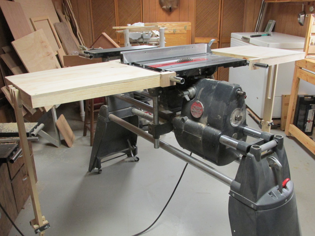

All these ideas for infeed/outfeed table extensions got me to finally doing something about this. Every time I have to start with a new 4x8 sheet of plywood, I wish I had a larger work surface. So, I put together two extensions for that purpose. They can be used either as infeed or outfeed. I'll use them a few times and if I'm satisfied with them, I will likely make two more so I can put them side by side for a wider cutting surface for those large sheets of plywood. Mine are really simple and lightweight so they are easily installed and removed and can be hung on a large nail on the wall.
Re: Outfeed Table
Posted: Fri Dec 21, 2018 11:39 am
by dusty
Nice job. They might be heavier than is really needed but still a very nice job and a great addition to your Shopsmith. The outfeed table is something that I believe is needed on every machine.
I like yours but I would be lying if I did not acknowledge that I am very pleased with mine as well. The single advantage (from my point of view - biased though it is) is that there is absolutely no fuss when I need to raise or lower or tilt my outfeed table. I worked on the concept and implementation of my OFT for nearly a year. I expected one more iteration so it never received a finish (not even a wax job) but I am still using it nearly six years later.
