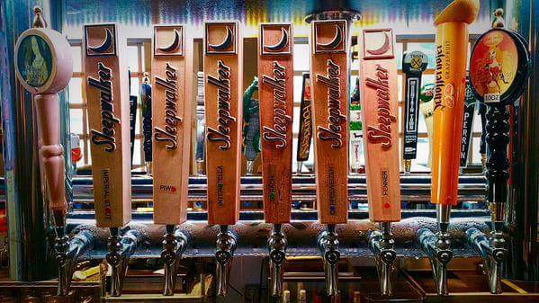

Some tap handles for local brewpub

They look very nice, it would have been great if you'd have provided some info on the process

by paulrussell
Oak handles have a thin maple cap on top for better contrast with paint.
Cut blanks 11" x 2" x 1 3/4", drilled end, then painted top surface black.
Carved relief on a CNC using a 90 degree V bit and a 1/8" flushcut bit for flat areas. The maple capped handles were cut deep enough to reveal wormy oak beneath.
Cut tapers on Shopsmith using a homemade jig.
Put dab of two part epoxy in mounting hole, then using a bolt to keep them aligned, hammered a pair of standard hex nuts into base.
Rounded off edges using hand plane. Light sanding. Finished with BLO.
Drank beer.
