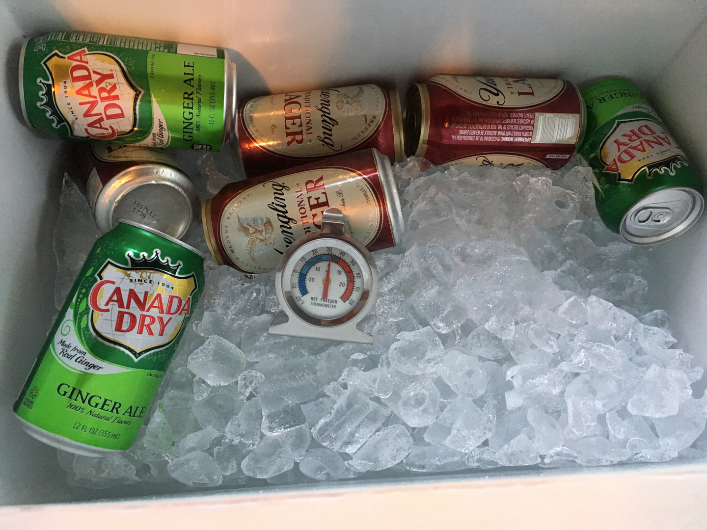

7 AM 8/15 (total elapsed time 64 hours 15 minutes). Still going strong. Internal thermometer 32 (as explained by Dusty and JPG it should stay there until the ice is gone). Overnight low temperature was 68 degrees.

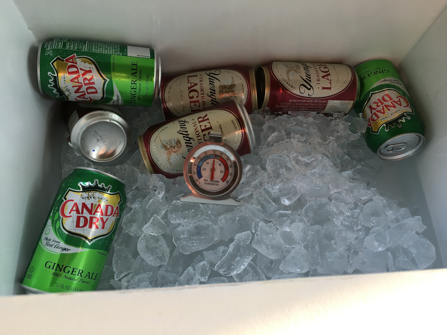

6:45 PM 8/15. Total elapsed time: 76 hours. Still 32 on the inside thermometer. Today's high temperature was 89 degrees.
The melt rate appears to be picking up pace but the beer is sill perfectly chilled! :)

The beers seem to be dwindling! Will they even outlast the ice? :eek:

BuckeyeDennis wrote:The beers seem to be dwindling! Will they even outlast the ice? :eek:
Those beers are evaporating. ;)
Re: Wannigan/Cooler Build
The water is likely near 32 and does not change when it is opened(hence the do not drain advice).
It should stay near 32 until almost the last chunk of ice is melted.
That last chuck will melt quite quickly I predict. The available 'heat of fusion' will diminish quickly with the decreasing mass.
