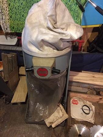

Here is the SS I just purchased. No I'm not selling it, easiest way to show pics.
1- vacuum
2- SS
3- jointer
4- saw blades and accessories
5- accessories
6- random attachments I don't know what they are
7- random piece
8- fence and smaller fence
9/10 inside
Blew out saw dust and cleaned outside so far after pics were taken. Oiling and waxing tomorrow. I want to take jointer apart er and go through it thoroughly.
