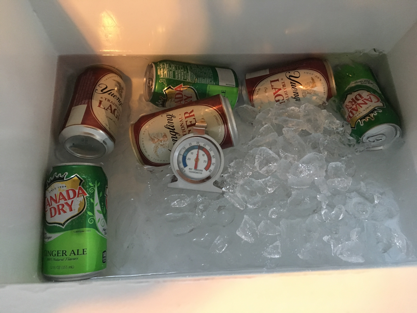

8/16 at 6:45 AM. Elapsed time is now 88 hours. Inside thermometer is at 33 degrees. Overnight low was 68 degrees.
Looking at the accelerating melt, I can only conclude that by taking a beer out of the cooler last night I must have set off some kind of exothermic reaction. :D :rolleyes:
It is supposed to hit 90 today so I will be curious to see if any ice survives to the end of day 4, which will be at 2:45 PM. I won't be home, however, at 2:45 PM. So, I will check back in around 7 PM.

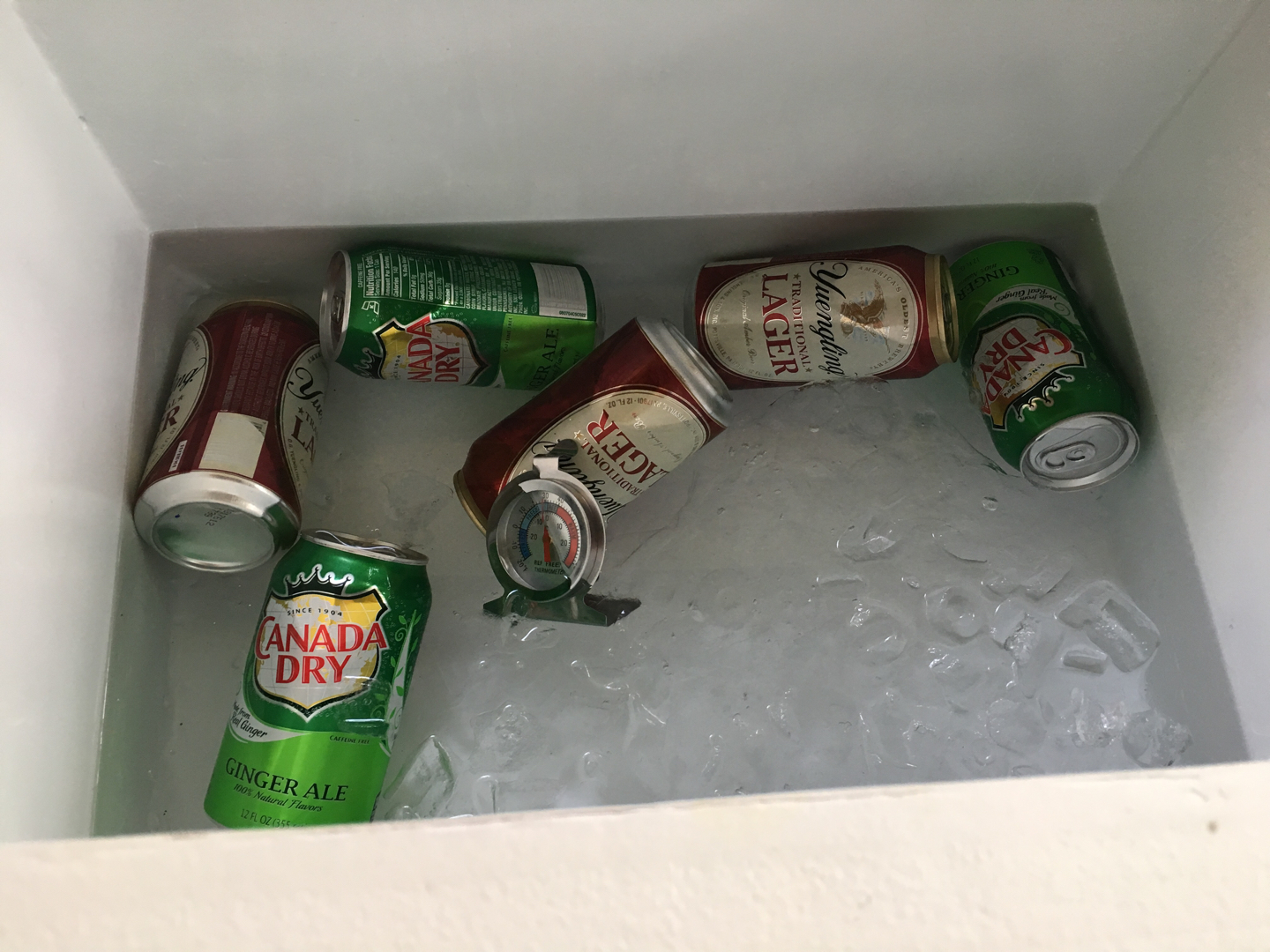

8/16 at 6:45 PM. Elapsed time 100 hours! And there is still ice! I assumed I would come home to all water but there is still ice, and not just chips. Mostly submerged though it may be, there is still a block of ice in there. Thermometer (also partially submerged) reading 29 degrees. Outside high temp was 89 degrees. I consider this test a total success even under sub-optimal starting conditions and am drinking a victory brew as I write this.

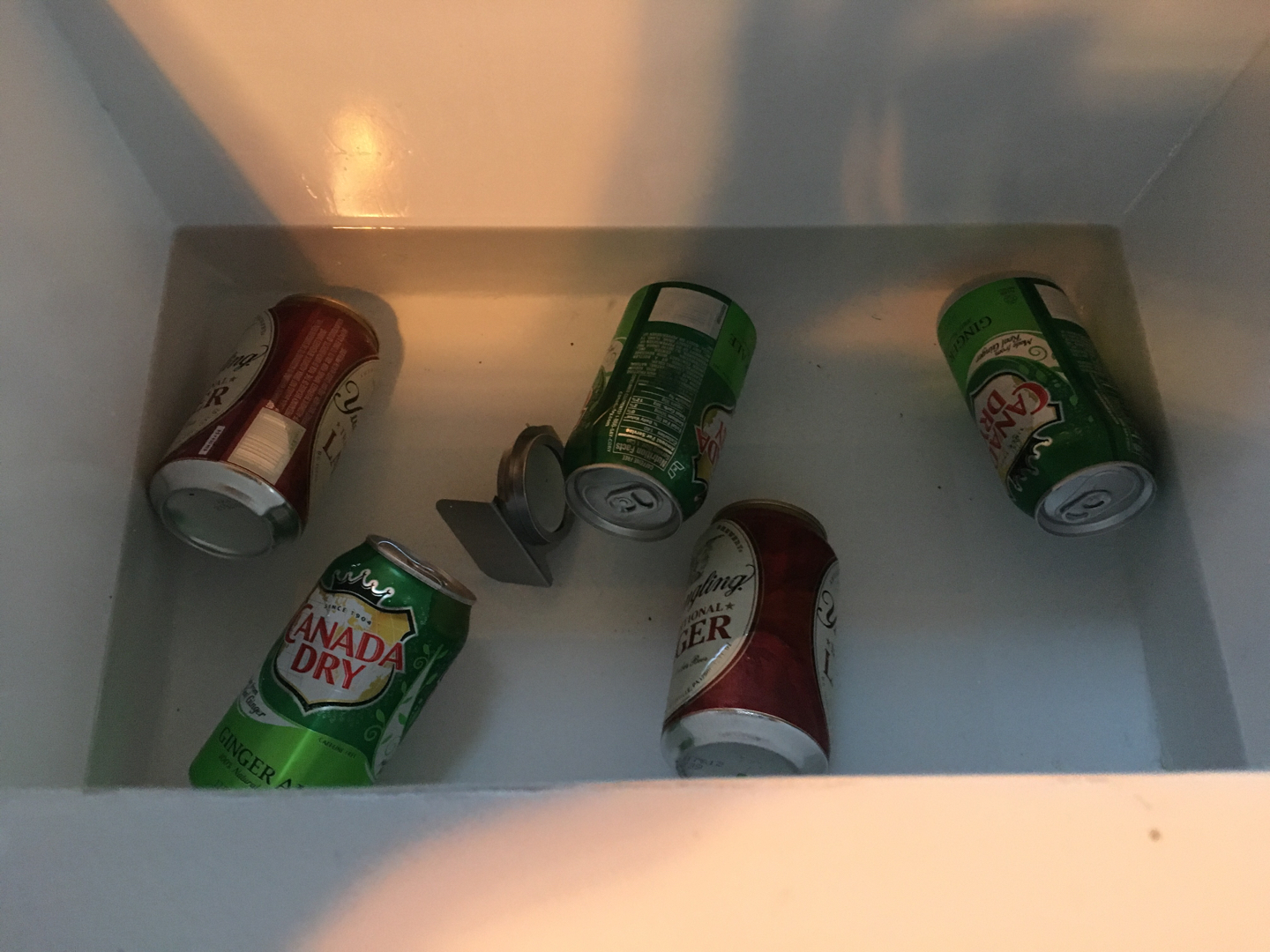

8/17 6:45 AM. Time elapsed 112 hours. The last of the ice gave up the ghost overnight (low temp 76 degrees). The water, however, is still just below freezing and will keep these beers/sodas comfortably chilled a while longer.

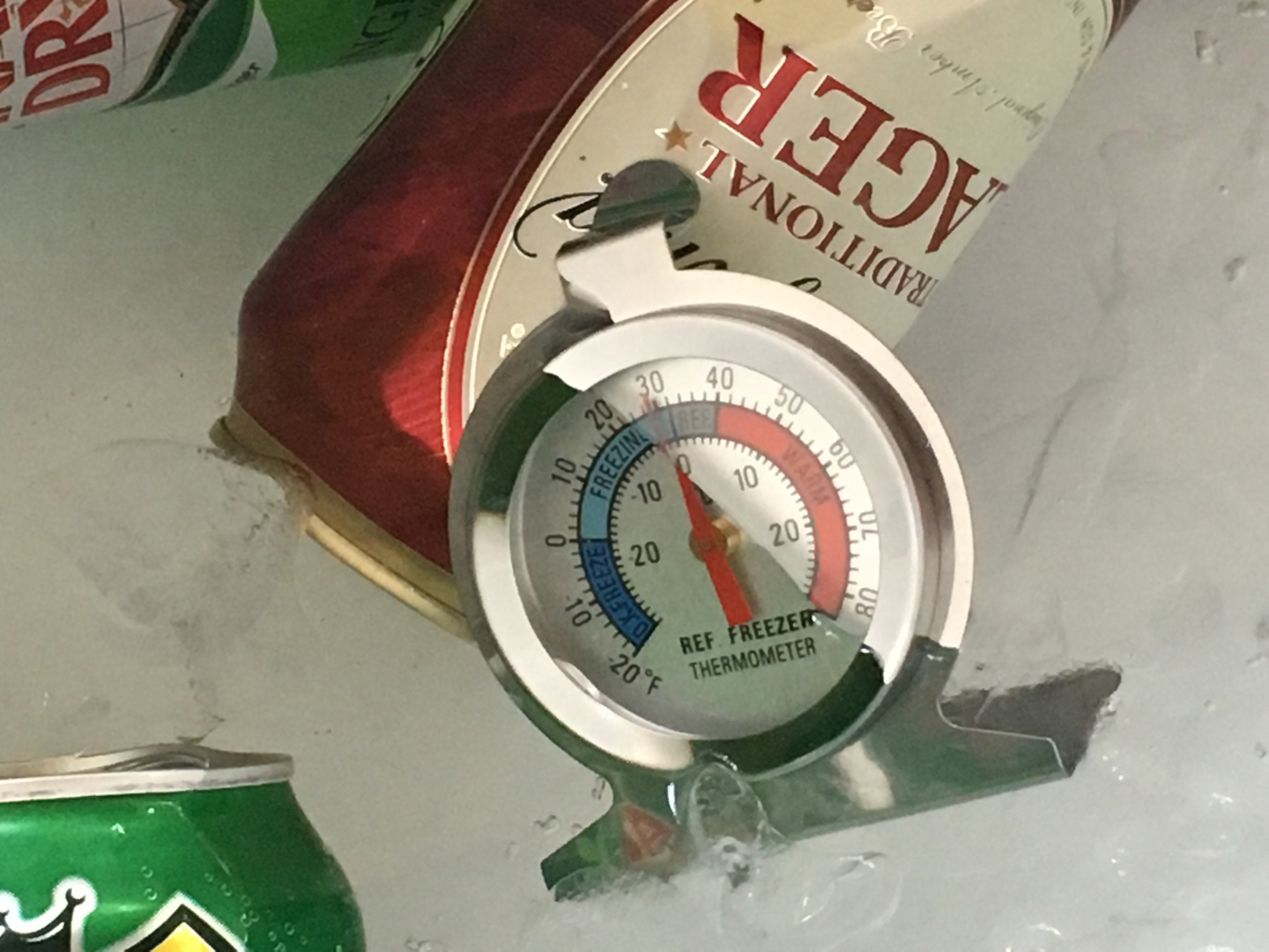

I think yer thermometer needs tweaking. :D
About 3.5° should correct it. ;)
Posts: 3814
Re: Wannigan/Cooler Build
JPG wrote:I think yer thermometer needs tweaking. :D
I had the same thought at first, and it's probably about right. But then I realized that I was assuming pure water. Remember how zero on the Fahrenheit scale was established?

Thermometer seemed accurate perched on the ice...

The coldest temperature that Fahrenheit could create in his lab back then was achieved by mixing a salt with ice water. He chose the resulting temperature as "zero" on his temperature scale.
That's why you mix salt to the ice when making ice cream the old-fashioned way.
Impurities affect both the freezing point and the boiling point of water, as does air pressure. I once needed to verify the calibration of a new thermocouple-measurement circuit that I had designed. I used the boiling and freezing points of water for that purpose, because the equipment cost was close to zero. But I was careful to use distilled water, and to correct for the current atmospheric pressure.
I also learned that thermocouple wire conducts significant heat away from it's own bead. To measure the boiling point accurately, I had to form a steam shroud along the first foot or so of thermocouple wire, after it exited the flask. Without the steam shroud, the temperature measurement was about a degree too low.
