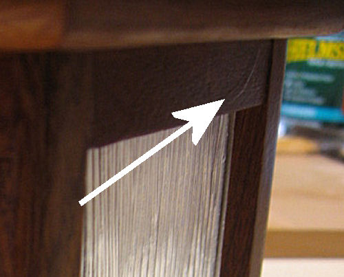

But to find my other mistake, look at the rails.
You can trust me Heath....I won't tell anyone. :p
[ATTACH]9693[/ATTACH]

mickyd wrote:You can trust me Heath....I won't tell anyone. :p
Nope, still not what I'm referring to. Although I saw that on the photo and I'm not sure what it is. I didn't see it on the actual lantern. I don't know if there's a problem there or if it's a trick of the light and shadows. I'll have to check it out when I get home tonight.
Heath
Central Louisiana
That is a hair Mike! Notice it has a shadow! Blow it up bigger to see!
Hint: around the opposite corner:D

There isn't a candle in it yet. The light you're seeing is just a reflection in the glass. But, I think I see what you're talking about. The base, where the candle would sit, has a rabbeted edge. The rabbet is wide enough so the thin part of the base fits into a groove in the bottom rails and for the glass to fit inside the rabbet. This holds the base in place and the bottom of the pieces of glass in place.
When I ran into my problem with the sides being too narrow and not coming together at all of the corners with the base in place, my first attempt at fixing it was to trim the base off a hair on all four sides. This didn't work and if I had gone any further with the trimming, I would have had to make a new base. Consequently, with the corners successfully patched and the lantern assembled, the base was a bit loose in the grooves. Yes, it might have twisted a little so that the gap where the glass sits is larger at one end of each side than the other end.
But, that's still not what I'm referring too!
So I have two ways to look at this... 1) The mistake I'm referring to (which I considered a big one) isn't very noticeable at all, or; 2) I have more problems here than I thought I did! :eek:
