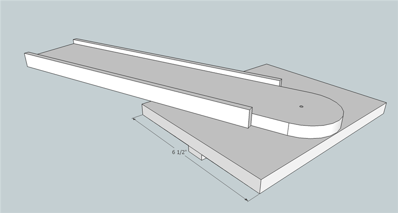

Is it obvious what I am trying to do here?
[ATTACH]16653[/ATTACH]
ZCI Rounding Jig (Custom).png (63.65 KiB) Viewed 3102 times

Is that for rounding off ZCI's?
Tim
a1gutterman wrote:Is that for rounding off ZCI's?
Yes, that is what it is for.
I round the end first, cut it to length, install it in the ZCI Sled (on the Mark V Table Saw) to cut the kerf, install it in the same ZCI Sled (on the Mark V Drill Press) to drill and countersink the holes.
I believe that I'll be able to do a batch of about twelve ZCIs in less than an hour.
I have been scribing the round end with a compass and sanding them to the line on the belt sander. This doesn't take long but I screw up ever now and then.

And here I thought that you were building a clay pigeon thrower... :)
a1gutterman
Posts: 3653
Location: "close to" Seattle
Post by a1gutterman »
I think it is a good idea, Dusty.
Tim

What's a ZCI?
Hand Engraver of Metals; Maker of Exquisite Kindling; 1955 Greenie Mark V (NOW with a 1989 Headstock); Magna Band Saw; Magna 4" Jointer; Miscellaneous Craftsman & Porter-Cable electric woodworking tools.
3D CADCAM Designs - Gemstone Facetor
mgdesigns wrote:What's a ZCI?
Zero Clearance Insert. Saw blade insert that has no(or very little) clearance to the blade. Made by installing the insert to the table, and creating the blade slot by lowering the table/insert down onto the blade.
