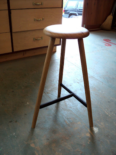

While I agree with your point about the cross grain gluing, I have to leap to the defense of the three legged stool. Well designed they are absolutely stable, never teeter like four leggers and tuck into tight spaces.
I have one in my shop and I absolutely love it. IMHO of course.
[ATTACH]16835[/ATTACH]

bffulgham- Thank you for the lesson. Pictures certainly speak louder than words. Did the splitting happen over a year or two, or did it take decades?
Paul- Could you please elaborate on "well designed" for a three-legged stool? Yours looks like the the three feet are outside the seat circumference, and the legs are splayed outward. Are those characteristics "standard"?
We have a short three-legged stool that we inherited. The three legs are vertical (not angled), and the feet are well within the seat circumference. (We named it "Killer" after a couple of "oopsies' using it as a stepstool.)

shipwright
Posts: 1165
Post by shipwright »
greitz wrote: Paul- Could you please elaborate on "well designed" for a three-legged stool? Yours looks like the the three feet are outside the seat circumference, and the legs are splayed outward. Are those characteristics "standard"?Gary
About a year ago I did up a photo tutorial for Mickyd on how to build one. You'll find ithere.
Enjoy.
Paul M
