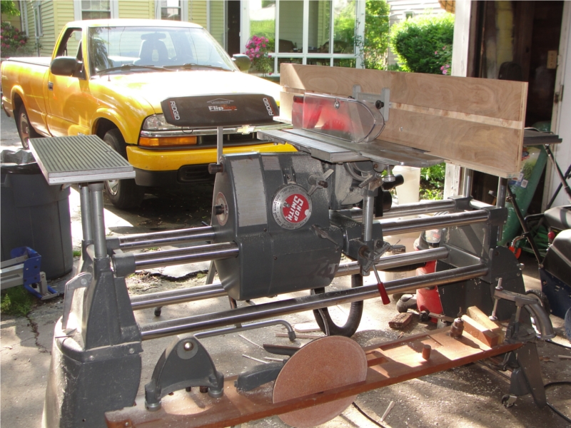

Here is a pic of my Mark V set up to cut some 2 by to 3" widths. No biggie here setting the fence once you get used to it.
[ATTACH]17423[/ATTACH]

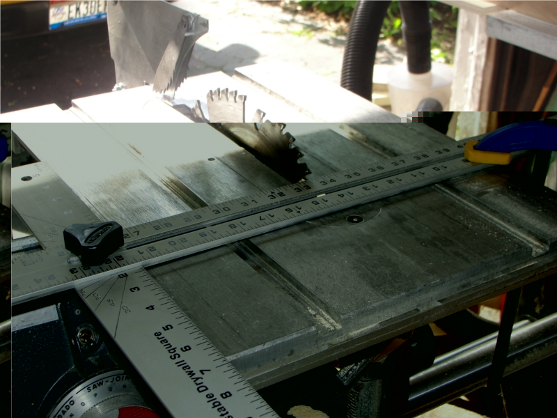

Here is a pic of what I was referring to earlier about using a metal drywall square or similar ruler that is stiff.
[ATTACH]17421[/ATTACH]

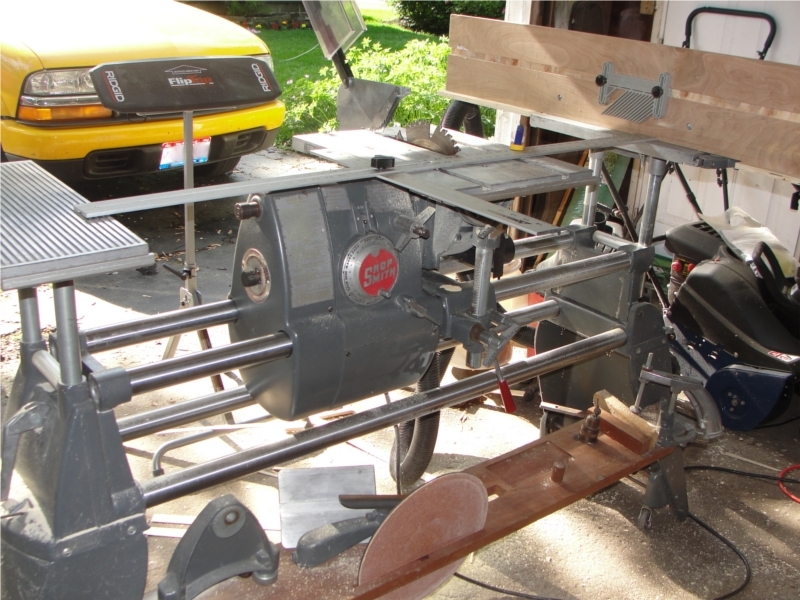

Clamp the ruler/square at the measurement you want and slide the headstock/carriage toward the fence.
[ATTACH]17422[/ATTACH]

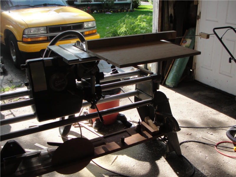

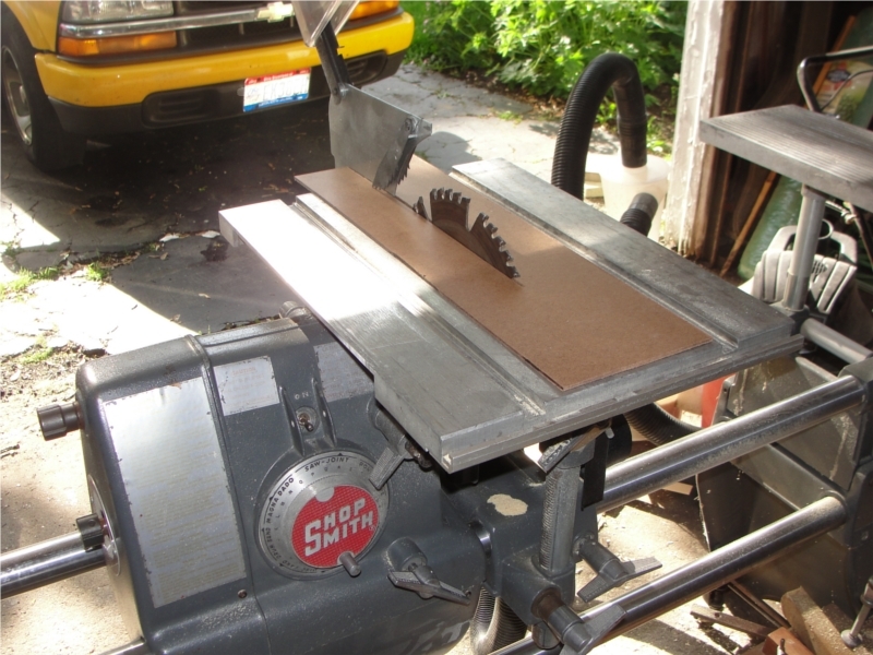

One other trick I use is this hardboard guide seen below. It's 6"x20" with a 14" cut that can be used to help set the guard/splitter quickly. Especially if you've adjusted the quill to set the blade just right.
[ATTACH]17424[/ATTACH]

TheBigE wrote:Here is a pic of my Mark V set up to cut some 2 by to 3" widths. No biggie here setting the fence once you get used to it.

Interesting setup! I would say part of your consternation is the fence extension getting in the way of easy access to the fence clamping knob. It also gets in the way of applying slight pressure to the fence while sliding it.
You have not mentioned the really PITA attribute of wanting to set the fence straddling the main table and the extension table.
