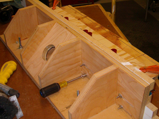

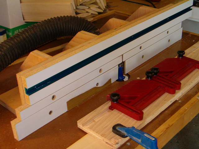

Here's my fence - The dust collector works wonderfully well!

- New Router Fence.jpg (138.47 KiB) Viewed 16728 times
- router setup 1.jpg (141.26 KiB) Viewed 16696 times
- Rear of fence.jpg (134.23 KiB) Viewed 16665 times
- Dust collector box.jpg (123.66 KiB) Viewed 16666 times

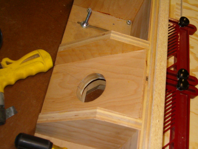

Can you elaborate on that dust collection box on your fence? That looks like something I would like. Is it just a piece of plywood glued at an angle? I see something black and white in there.
Not much to elaborate on, but here goes - the base has a cutout (you can see through the top of the dust collector hole). I made 45's at the corners of the cutout in the base which helps prevent chips getting caught in square corners. The top is just a piece of ply, mitered on the upper and lower edges to fit - and the sides were trimmed to just fit between the fence braces.eldyfig wrote:"...Can you elaborate on that dust collection box on your fence? That looks like something I would like. Is it just a piece of plywood glued at an angle? I see something black and white in there.
Also you can see the slots and bolts, through the base, for forward and backward movement of the fence. I made two sliding faces for the fence. For the fixing (placement) of the upper portion of the fence, I slid credit cards between the two lower fences, the upper portion and the table. This makes sliding (adjusting for different bits an easy thing. (not real credit cards - the ones I'm always getting in the mail for free. Had to find a use for them somewhere!)

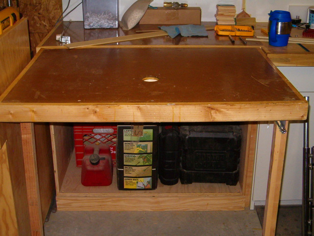

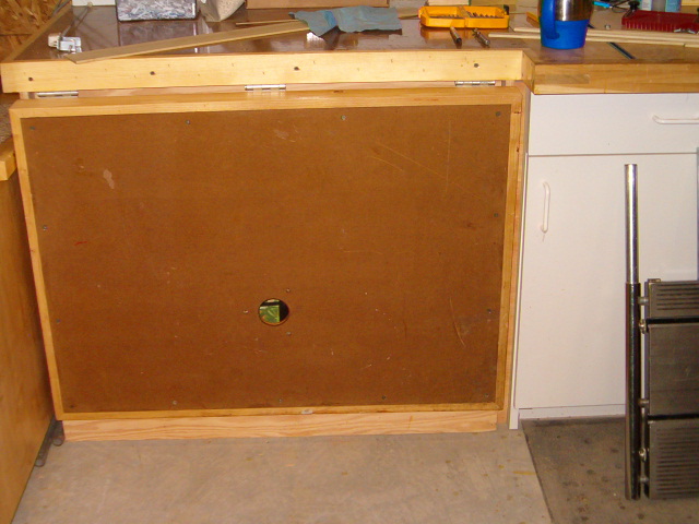

This fence sits on a folding table copied from Norm's "Garage workshop"
- fold down router table.jpg (115.68 KiB) Viewed 16697 times
- table up - storage below.jpg (121.36 KiB) Viewed 16684 times
