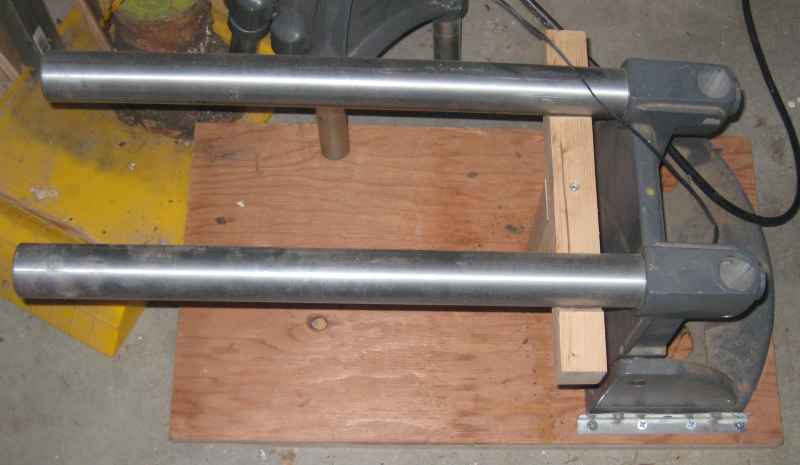

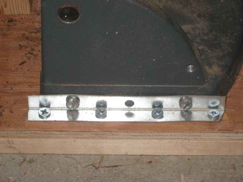

I have a bench end mounted to some plywood with short tubes for headstock maintenance purposes. I used some metal straps that are at a right angle and have a bunch of holes already drilled in them. Not sure if its strong enough for standard use, but it has worked fine for holding headstocks while I have been dropping motors and such.

damagi wrote:I have a bench end mounted to some plywood with short tubes for headstock maintenance purposes. I used some metal straps that are at a right angle and have a bunch of holes already drilled in them. Not sure if its strong enough for standard use, but it has worked fine for holding headstocks while I have been dropping motors and such.
A picture would be nice to make me understand what you are doing ....

camerio wrote:A picture would be nice to make me understand what you are doing ....
[ATTACH]17695[/ATTACH]
[ATTACH]17696[/ATTACH]
Service Mount.jpg (28.33 KiB) Viewed 2849 times
Service Mount - Detail.jpg (31.96 KiB) Viewed 2848 times

That's what I'm thinking, but with a heavy gauge of angle iron, either lagged or through bolted to the bench.
