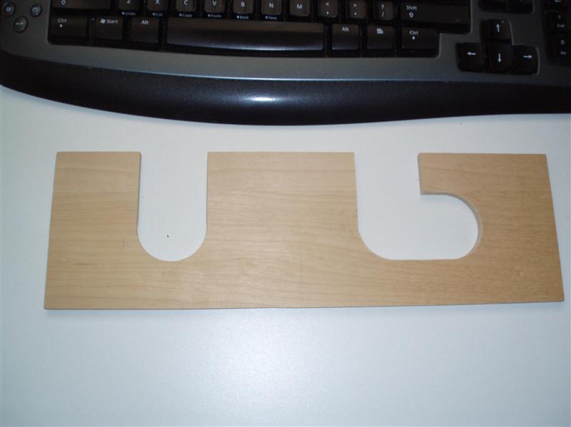

I recently introduced a 'shorty' into my shop environment. The shorty will spend most of its time configured as a drill press. The rest of the time it will be configured as a jointer station.
In the drill press mode, the table will be quite a bit lower than I am used to but I am already getting to like it. I will, from now on, sit down when I am working at the drill press.
As a 'dedicated drill press' I decided that I needed a fixed stop for the carriage. A stop that I could readily take off (disengage) whenever I wanted to relocate the carriage.
This is an image of the router pattern that I created to be used to build the stop. There will be no more bottle jacks in the set up and no more slipping tables while I am drilling.
[ATTACH]17741[/ATTACH]
This is just a pattern. The finished jig will be 4 of these made from 3/4" plywood or MDF. Think Way Tubes.

Great idea I cannot wait to hear how it works out. Jim

Hi Dusty! Good idea if you want a carriage that is 6" above the Base assembly. Also a good idea to do your drilling sitting down!:) I've done that for years!
What I fail to understand is why you would need to raise the carriage above the Base Assembly. When I use the drill press (and I'm about the same height as you) I slide the carriage all the way to the base prior to raising the tubes to vertical. Yes, I use a small screw jack to hold the headstock in place. Between the headstock and the jack is a block of wood with reverse curves to fit between the tubes and a 1/2" hole that provides a place for the motor case screw.

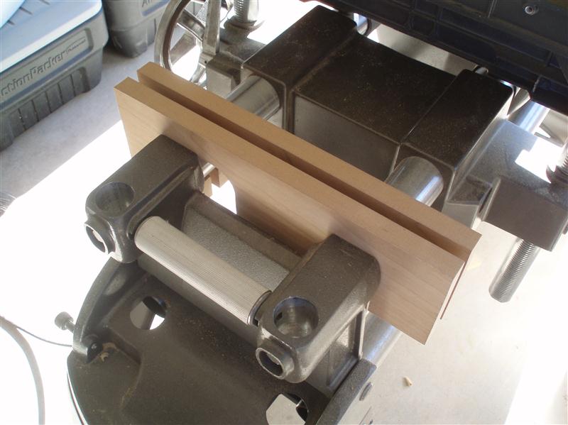

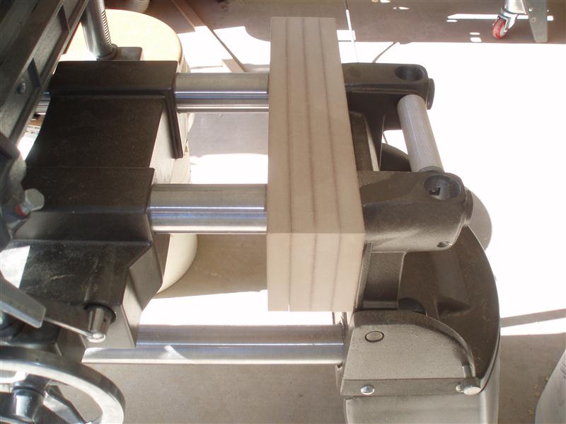

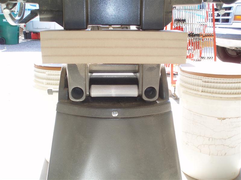

[ATTACH]17747[/ATTACH]
[ATTACH]17748[/ATTACH]
[ATTACH]17749[/ATTACH]
I gotta low bucket (HD 5 gal orange) but with my bum knees, if I sit in that position very long, I can hardly standup and walk.
It's done. Now I gotta get back to refinishing the RV table.
- height Gauge 002 (Custom).JPG (61.24 KiB) Viewed 3349 times
- height Gauge 010 (Custom).JPG (58.03 KiB) Viewed 3349 times
- height Gauge 014 (Custom).JPG (62.99 KiB) Viewed 3355 times
