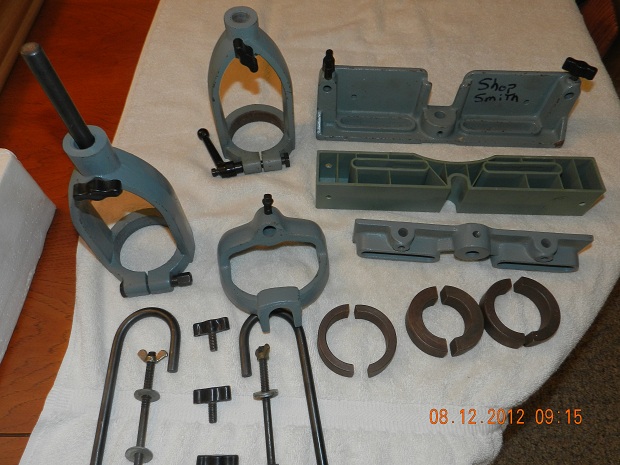

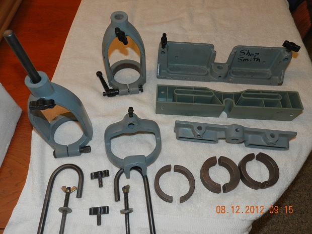

Help here is what I have...see pictures..I have tried about every way I can think of..The inserts are to loose or to tight..Could you give me some quidance to how to set this up???

foureyes45 wrote:Help here is what I have...see pictures..I have tried about every way I can think of..The inserts are to loose or to tight..Could you give me some quidance to how to set this up???
Sorry, that's not Shopsmith's mortise and tenon set and I don't think it is going to work with a Shopsmith. Here's the mortise set from Shopsmith for comparison purposes. http://www.shopsmith.com/ownersite/cata ... _pkg_l.jpg

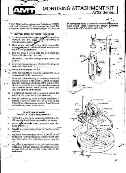

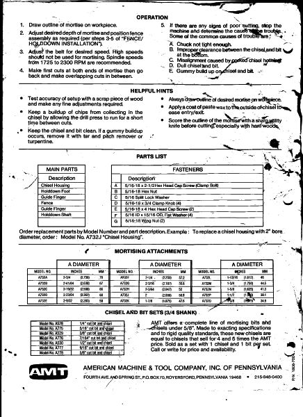

You have an AMT mortising attachment kit. It was available with different quill diameters. The chisel shank diameter is 3/4"(ss are 5/8"). The model for a 1 3/4" quill is A732M. If yours is larger than 1 3/4", an adapter should be possible(I believe that is what those split rings are).
