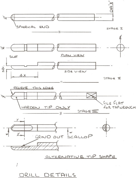

Make yourself a 'D'-end drill bit like this:
[ATTACH]18242[/ATTACH]
Easy to do, and it will make dead-straight holes for almost as long as you want to make them. Whistle and flute makers use these to bore the stock. Bore a short starter hole, then it is almost as easy to use a 'T'-handle and bore manually. The little sideways hole (which becomes a half-hole) acts as a catch to draw out the swarf from the cut.

Looks like no place for waste to go would need to go a little at a time.derekdarling wrote: Easy to do, and it will make dead-straight holes for almost as long as you want to make them.

Thanks lightnin. I will have to give that a try. Even if I have to go slow, it would still take care of the boring out!
Quick question: what is the best thing to make it out of? i see it says to harden the edge. I am guessing this is metal?

swarf = waste:)lightnin wrote:Looks like no place for waste to go would need to go a little at a time.
I would suggest piano wire.stickthrower wrote:Thanks lightnin. I will have to give that a try. Even if I have to go slow, it would still take care of the boring out!

Use drill rod. Any decent metal shop should have some. Get the diameter you need, and find out if it is oil or water hardening. This will become clear. Round over the end and drill a hole through the side dead centre as per the drawing. Then cut or grind off one side so that the hole you just drilled becomes the groove across the dia., and the resulting shape is like a 'D' end-on. Sharpen with the normal methods. To harden, heat it up to a dull red, then quench in oil or water, depending on the type of steel. You might hone the sharp bits after hardening. As this is designed for hand use in wood, you shouldn't need to anneal it.stickthrower wrote: Quick question: what is the best thing to make it out of? i see it says to harden the edge. I am guessing this is metal?
Thanks again
Nathan
To use it, first drill a 3/16" deep hole of the same diameter, then insert the bit. Turn and push (doesn't really need a lot of pressure), and drill a bit, then pull the bit out. The little groove will catch the swarf, or cuttings, and pull them out of the hole. The design is brilliant, the rod is essentially guided by the cutting end, and therefore has no inclinaiton to drill off centre.
I have drilled a 3/16" hole for a pipe (Irish) into cocobolo, 14" long, with a vanishingly small deviation from centre, something on the order of 3/100".
Derek
